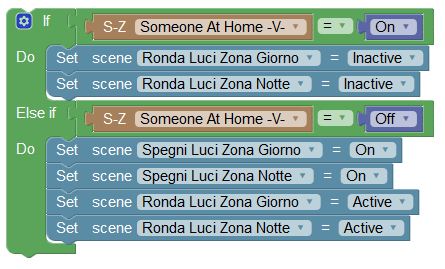

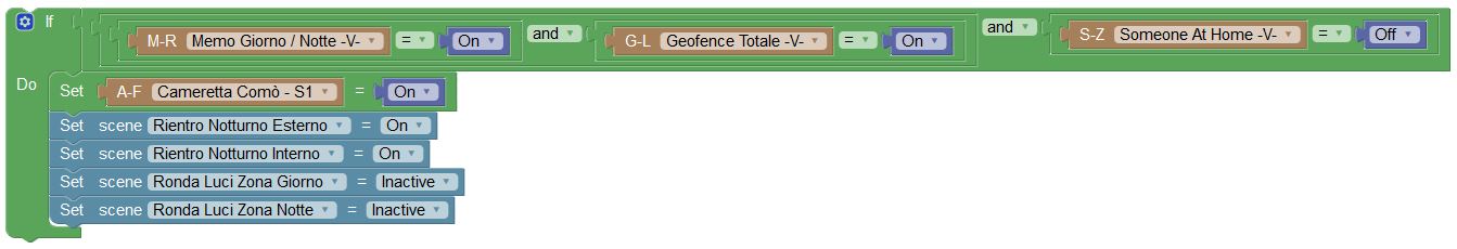

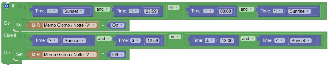

hallo, i made this 4 script blocky to work my light in day and in night.
the script A control if someone is at home. the 2 phone have the geofence installed on. work ok.
the script B tell me if the time is in night or in day mode. work ok.
the script C disable some sequence if someone at home and switch off all light and enable some sequence if nobody at home. work ok.
the script D switch on some light and switch on some sequence. but not work and i don't so why.

Re: Blocky script for light not working
this is the 4th script.
Ciao,
just a clarification
scirpt D should run ONLY during the neght (should be better to use Time = NightTime instead of using 1 dummy and few time test condition?... just a question
I assume that Geofence will trigger the presences scripts (are they Device Events?)
in script C you set a 10sec delay to set Someone At Home -V-, so script D should run during that time... but I assume that after 10 secs... there are no geofence activation, so the scripts does not trigger....
try to put some debug messages with the status of the tested switches...
Have you also cosidered to use LUA instead?

First, replace the Script D "If" Block with the "If" block without the blue "Else If" control. The control you have used will not work without an "Else If".

hi stanHD, i made it and the script work now. i take a big mistake. now i reply to the ather user over.StanHD wrote:First, replace the Script D "If" Block with the "If" block without the blue "Else If" control. The control you have used will not work without an "Else If".
