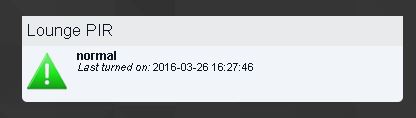

The screenshot I pasted was from dummy sensor I setup in March (When it last communicated). The title is not red. :(

Use the default Domoticz theme and it will probably work. Looks like the theme you are using is not supporting the colors.

I've set the theme back to default but still don't see any titles changing to red? (Tried FF/Chrome on Win10)
Domoticz is running on my R-Pi (v5859)

I guess it depends on what kind of (dummy) sensor you use.
I have registered a nearby PIR, probably from neighbours, with is seen more then two weeks ago. It does not show a red mark.
However some nearby rain/temp sensors with last data from more then a 24hours are RED, also dummy's for temperature old nas-device.
Also working as explained above with ThinkPads Theme and Default Theme.

Sensor type: Dummy (Does nothing, use for virtual switches only)
Subtype: Alert

Dummy Device is builtin and won't disappear after update.
Like i mentioned earlier, some get a red titled widget when they are last seen more then 1 hour ago, some aren't.
As i have a mix of dummies and nearby sensors, i can tell you weathersensors and utilitysensors get a red title bar after 1 hour. Some securitydevices wouldn't.
Does anyone know what code to change to get the sensor label to turn red on utility sensors. Its working fine on temp sensors - turns red after not reporting for a while, but not for utility sensors.

it does here... maybe not for all sensor types (like from dummies), what type of hardware/sensor are they ?

Trying to use a dummy sensor (virtual switch)
