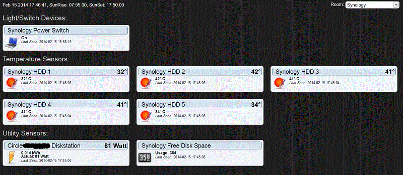

Upgraded synology dsm 4.3 3210 to 4.3 3810 and vola... there it is
Nixta
- Posts: 9
- Joined: Thursday 13 February 2014 16:03
Re: HowTo: monitor Synology NAS
Just wanted to show you the result.
Cheers
/Niklas
Cheers
/Niklas

@rvmourik Thanx for the script!
Got it all set up within 30 minutes.
Configuration: DS1010+ DSM 4.3-3810, Raspberry PI Domoticz V1.1492 ( and a Plugwise Circle for the power consumption)
