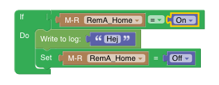

I have the following very simple blockly script
Screen Shot 2016-11-16 at 13.42.47.png (19.4 KiB) Viewed 898 times
which is supposed to write "hej" to the log whenever I push a button on a remote.

But the blockly is never triggered. I have tried saving both as a "Device" and "All" script. If I push the switch on the webinterface the blockly is triggered correctly.

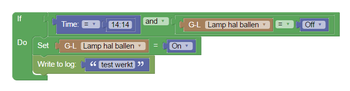

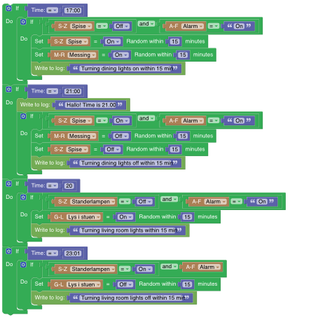

I have similar problems with other scripts which are not triggered e.g. by time

Do you have any suggestions or should I simply write everything in Lua?

remote are push button.. could it be that by the time the script triggers, the button is already off
try to add 1sec delay in deactivation in the button config and see if there are differences

In your first problem you use a different name in the script than you use for the button.
your second issue, is maybe wrong use of if/then/else.
If I build the same it also does not work.
that will work.
