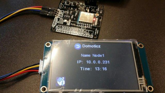

works ok with esp easy still figuring out how to get all the dataayasystems wrote:HiDerik wrote:mmm
Perhaps espeasy?
http://www.letscontrolit.com/wiki/index.php/ESPEasy
Works stable with domoticz
I know ESPEasy... but i don't know how use it to read data from domoticz.....
I'm ussing ESPEasy to receive the data and then print it into Nextion but i'm searching the way to do all with ESP8266....
Read the domoticz json data and print into Nextion the relevant data... I don't know how i can manage/decode the Json domoticz output in my ESP8266.....
Regards!

there is already a nextion plugin for espeasy.
but you can also use the net2serial plugin to do the same thing

ayasystems
- Posts: 66
- Joined: Tuesday 19 April 2016 23:37
Re: How to get domoticz data from ESP8266??
I wrote a simple code to receive UDP package and send it to nextion. It is the best and simple solution for me.
