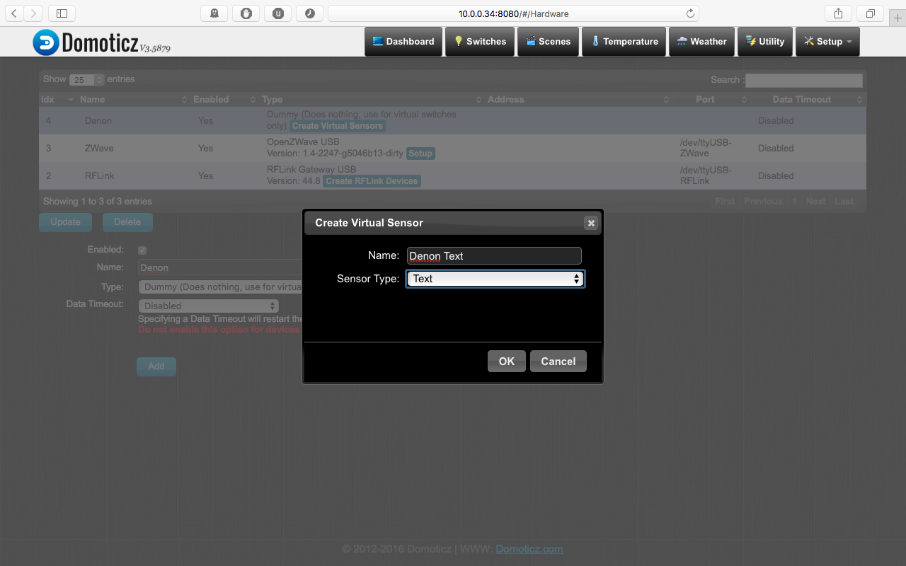

trixwood
Re: Denon AV Reciver - plugin
Post by trixwood »
The text is a virtual sensor type: "text"
Screen Shot 2016-11-13 at 20.52.40.png (245.79 KiB) Viewed 38381 times

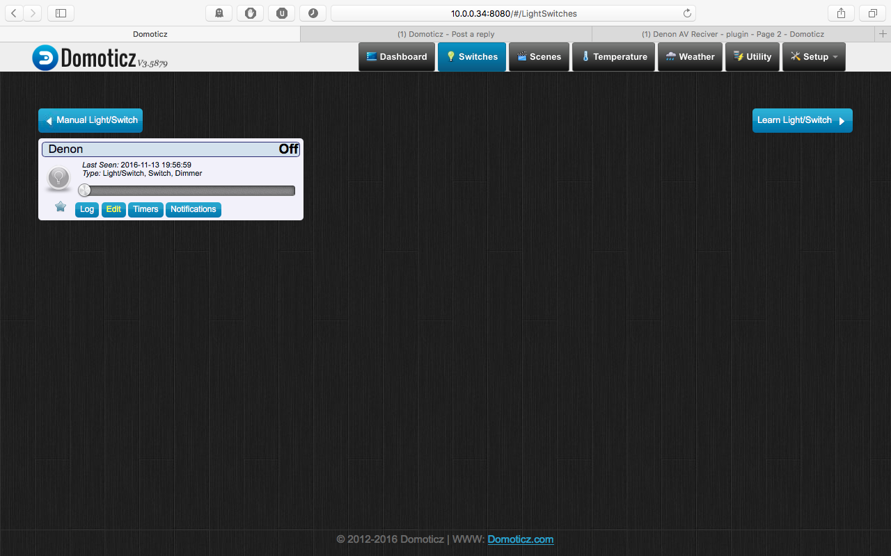

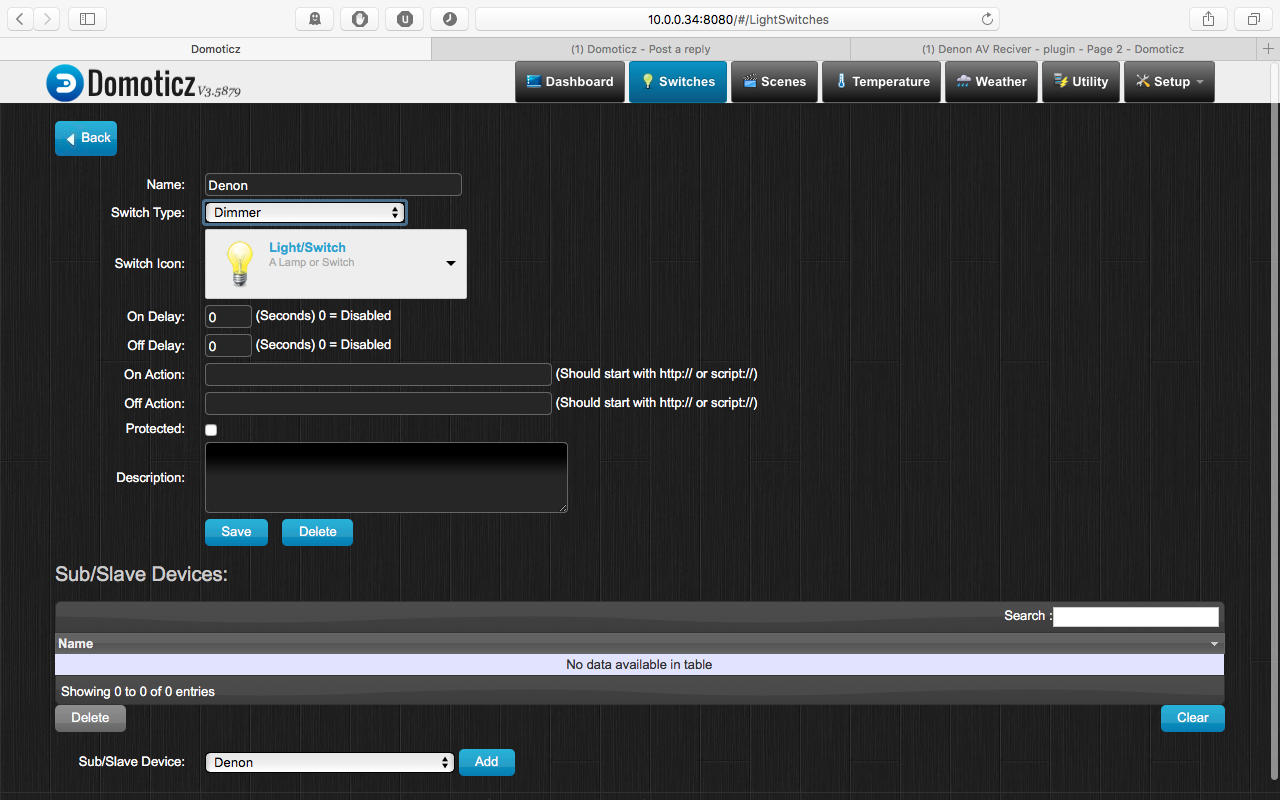

Slider is a virtual sensor type: "switch", to change it to a slider go add it to the switches view, go there and press the edit button and change on/off to dimmer.
Screen Shot 2016-11-13 at 21.00.22.png (310.11 KiB) Viewed 38381 times
Screen Shot 2016-11-13 at 20.57.37.png (324.49 KiB) Viewed 38377 times
Also here you can change the icon to a more amp style icons...

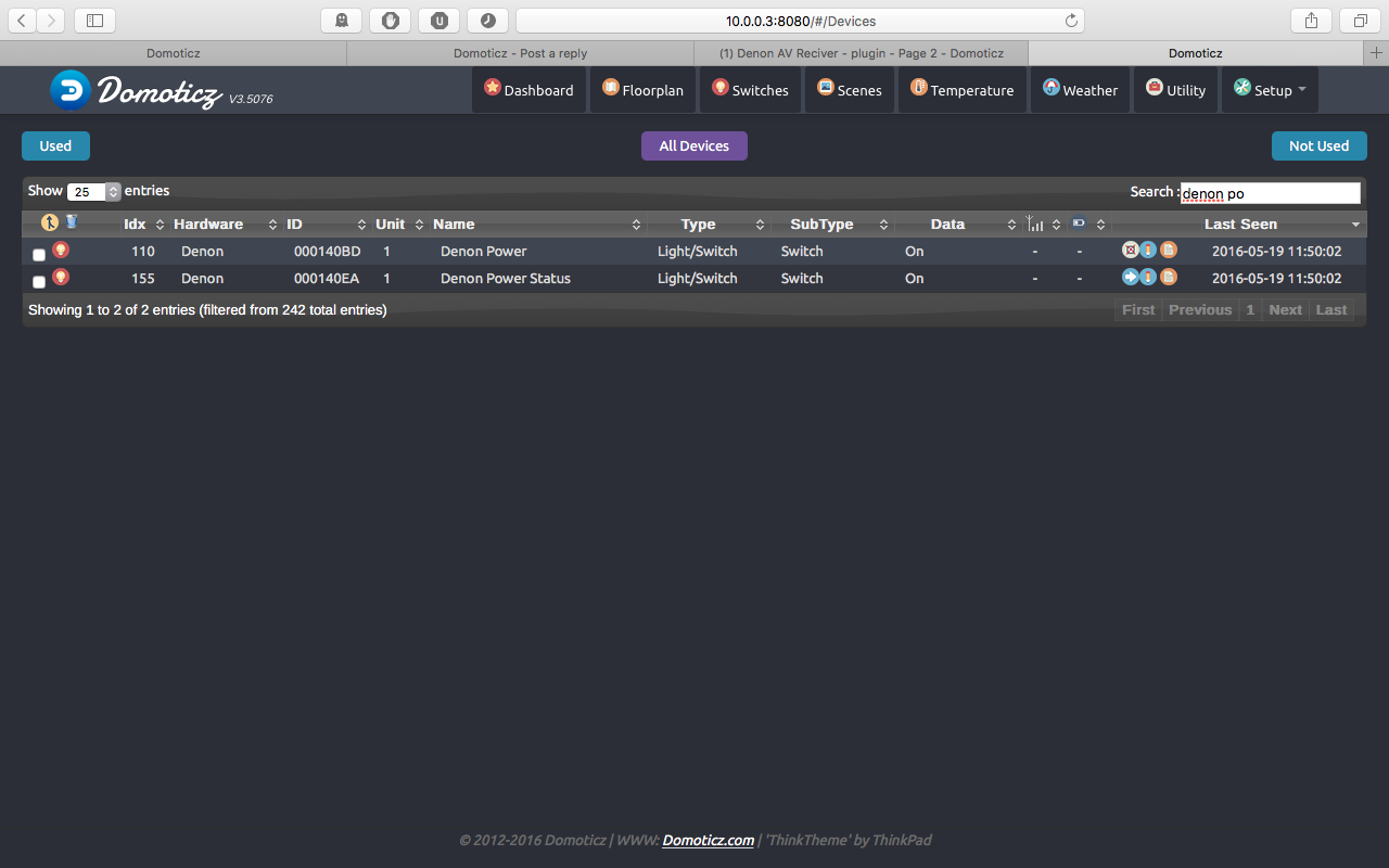

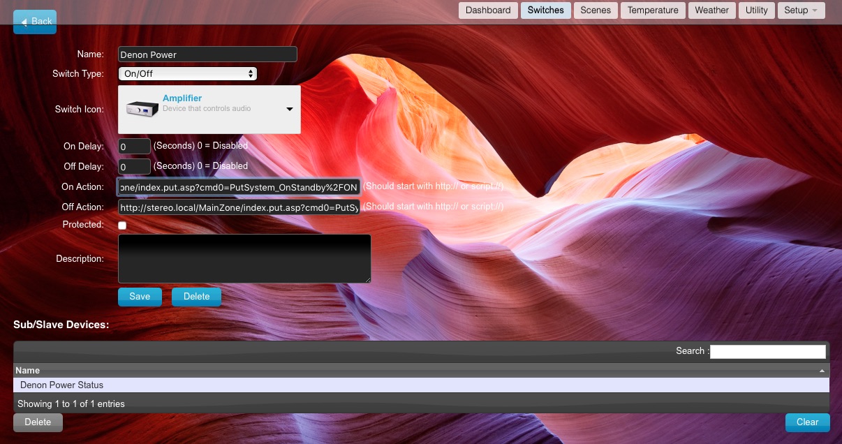

trixwood
Post by trixwood »
Abou the on/off with slave:
You need two virtual on/off switches.
One to receive the denon data from denon.sh (idx 155 in my case) and which you can remove, it out of your switches view
And one to control the actual on/off in domoticz, (idx 110 in my case) which contains the action url and the sub/slave
Screen Shot 2016-11-13 at 21.15.01.png (131.62 KiB) Viewed 38376 times
I you do not use two, the whole script looses status and the denon keeps turning on- off - on - off... probably because switching on or off cost time and the xml files are not available when in the process of switching on or off then... I did not have to use it anywhere else only when switching on/off
Hope it helps..
