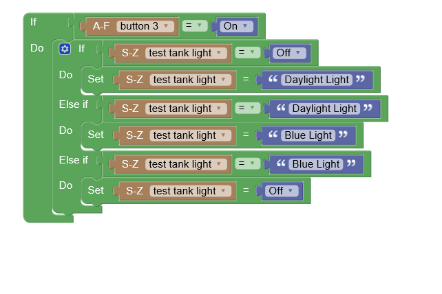

Any chance you could help me by showing how I could do it in Blocky, using an input on the Pi called Button 3?

When I push button 3, test tank light always goes to "off"
http://www.domoticz.com/forum/download/ ... ew&id=8372
