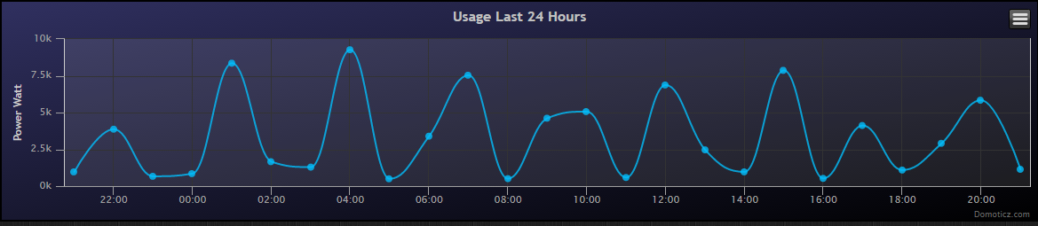

Hi.
The 24h graph of my 1-Wire (OWFS) counters only has 1 value per hour. This makes the graph quite 'undetailed'.
Is there some settings for the graph interval or anything else I could do to make the graph more detailed?
Screenshot:
Skärmklipp 2016-10-12 21.50.26.png (109.81 KiB) Viewed 9591 times
Thank you.

When I add a dummy meter of the same type and subtype, I get bars, also by the hour. That's correct behaviour since this type of device doesn't report actual power usage, only energy consumption. Ofcourse it's not that hard to calculate them, but that's currently not implemented. Still unsure why your system shows a spline though.
