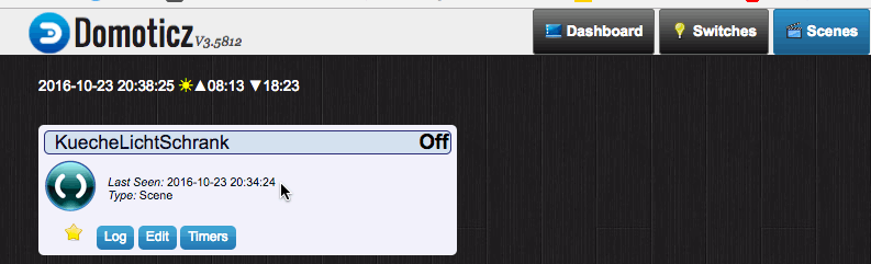

can you please take a look at the latest beta of Domoticz? Something is going wrong with the scenes & dzEvents there. I'm getting the following error with all of my scenes:
LUA: Cannot find the device. Skipping: KuecheLichtSchrank 1
I've deleted all scenes & recreated just the one above but the error remains. No more errors even in debug level 3.
I've also stopped Domoticz & deleted the devices.lua file so it can be build up from scratch but no luck at all :-(

Glatzi wrote:Hi dannybloe,
Best rergards
Stephan
Upgrade to the latest dzvents release.

Thx, that solved the error!

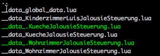

what is the reason for the __data. Dot files in the scripts/storage folder?

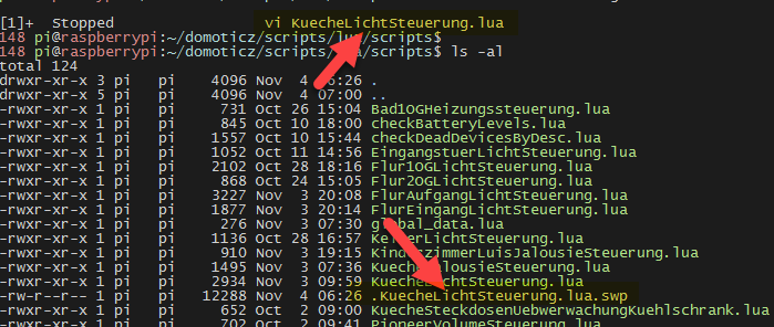

I got the same dot-file in the data directory. For me, the reason is that I'm using vi as editor and when you open a file in vi a backup file is created with a leading dot in the filename.
The backupfile is detected and evaluated as a ordinary script by dzVents/lua.
@dannybloe; A possible improvement to dzVents woul be to ignore script-files with a leading dot?
/Andreas
/Andreas
Aha.. that explains... we should certainly ignore those .dotted scripts completely. Right now they are executed as normal scripts!!
/Andreas
Hi Andreas,
when you edit files with vim the file is marked with a dot as a prefix & a suffix .swp
Anyway, this is no big deal.

dannybloe wrote: Aha.. that explains... we should certainly ignore those .dotted scripts completely. Right now they are executed as normal scripts!!
I'm very busy at home right now (renovation) which will take at least one or two weeks so I don't have time to fix that I think. I will try but no promises. On the other hand... pull requests are always welcome ;-)
Made a pull request (my first time, but hope it was done correct).
The current logic is to include all files that contains .lua
Changed to logic to make sure that the file ends with .lua and does not begin with a dot.
