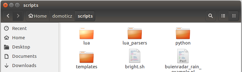

I've tested to confirm it works:
contents of bright.sh:
#!/bin/bash
echo -ne '{"id":1,"method":"set_bright","params":[50, "smooth", 500]}\r\n' | nc -w1 192.168.5.29 55443
bright.sh is located in the Domoticz scripts folder:
corbin

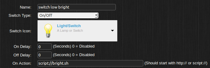

one more thing I just saw in your setup, you have 3 slashes. Change to two:
script:///home
change to
script://home
Derik
Posts: 1605
Re: [Plugin now available in Beta] Help with Yeelight Bulb
Post by Derik »
corbin wrote:one more thing I just saw in your setup, you have 3 slashes. Change to two:
script:///home
change to
script://home
Make no different...

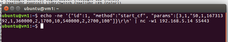

Terminal:
linaro@cubie:~$ cd /home/linaro/domoticz/scripts/bash/yeelight
linaro@cubie:~/domoticz/scripts/bash/yeelight$ echo -ne '{"id":1,"method":"set_s                            cene", "params": ["color", 65280, 70]}\r\n' | nc -w1 192.168.5.30 55443
{"id":1, "result":["ok"]}
{"method":"props","params":{"power":"on"}}
{"method":"props","params":{"color_mode":1,"bright":70,"rgb":65280}}
Light was off..
And after this on wih a green light...

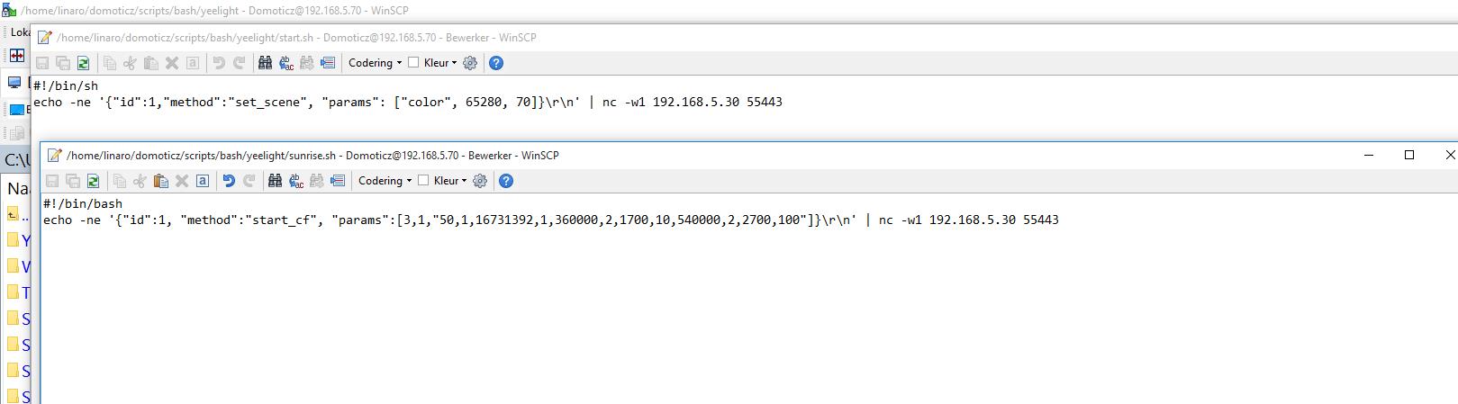

Can you upload your start_1.sh file please?
Derik
Posts: 1605
Post by Derik »

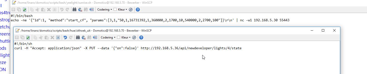

#!/bin/sh
echo -ne '{"id":1,"method":"set_scene", "params": ["color", 65280, 70]}\r\n' | nc -w1 192.168.5.30 55443
And then:
Working with the portal..

Derik
Posts: 1605
Post by Derik »
linaro@cubie:~/domoticz/scripts/bash/yeelight$ echo -ne '{"id":1,"method":"set_scene", "params": ["color", 65280, 70]}\r\n' | nc -w1 192.168.5.30 55443
{"method":"props","params":{"color_mode":1}}
{"method":"props","params":{"bright":70}}
Te correct way....
Looks
Light was chancing
Only i still get the script in the document not working...

There are 2 things.
1 says ok, only there is no thing happend with the bulb.
1 error.
When i use start in the terminal
The light is working ok.
is there perhaps a other type of script necessary..?

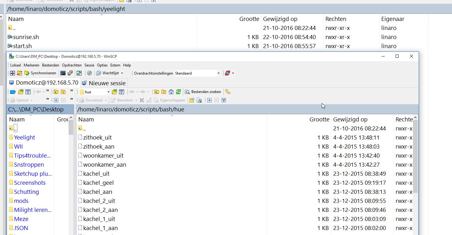

My Hue is ussing without the extention .sh
While there is in the the same, start.
#!/bin/bash

Did you create your Hue script file the same way you created the Yeelight file? Same text editor, file permissions exactly the same etc? Maybe try a Cubieboard forum and see if someone else can run the script ok.
Can you also post up more information about your Cubieboard setup?
Derik
Posts: 1605
Post by Derik »
corbin wrote:Did you create your Hue script file the same way you created the Yeelight file? Same text editor, file permissions exactly the same etc? Maybe try a Cubieboard forum and see if someone else can run the script ok.
everything the same
CB2 is the same setup as a Rpi.. so that cannot be the problem.
