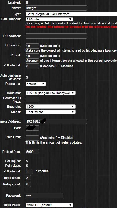

- Posts: 7
- Joined: Saturday 26 August 2017 21:50
Re: Satel Integra (Security System) with ethernet module
Thanks for your answer,]fantom wrote: ↑Sunday 03 September 2017 14:26 Hi
Ad 1. I have a plan but I don't know when I will do it.
Ad 2. Maybe use Security Panel in Domoticz ? Or set rights for user in Domoticz ? OR check "protected" on device ?
Ad 3. Baudarate ?? Where is this setting ?
Ad 4. All unused output, send error on start. This is normal and i didn't find solution for this problem (not exists in ethm1 protocol). Used outputs - don't log errors.
Ad. 5 I don't understand
Fantom
Ad 2 - I've thought about permanent disable of this function
Ad 3 - In hardware preferences - maybe you can give us a clear quide how to set all preferences as rate time refresh rate etc
ad 4 - OK
Ad 5 - for me it looks like to much data and system is crashing it is all the time when i've connected integra to domoticz. it works properly for few minutes then crash. Mayby I've some bad setting in hardware preferences ? (screenshot in attachment)
- scrrenshot
- domoticz-integra.JPG (91.71 KiB) Viewed 5148 times
- Posts: 269
- Joined: Thursday 26 March 2015 10:40
- Location: Poland
Ad 2. For me the best methos is set "protected" and set password in settings.
Ad 3. Lol. You have problem with cache or .. I don't know. This page is broken. Pls wiil try refresh www cache etc. Youu see to many fields on this page.
Ad 5. Pls check log after crash.

- Posts: 7
Ad 3 - you've right cache problem;) but still i can't change refresh rate it always back to 1000ms
Ad 5 few lines before crash and the fatal errors (the last line - manual service restart via ssh)
