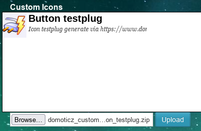

Update:
failing custom icon upload: if I select a zip file in setup/more options/custom icons and click upload, nothing seems to happen. I'm using Edge on Win10. In the past, I have used this feature with success.
There is an older (2 jan 2020) post https://www.domoticz.com/forum/viewtopic.php?t=30754 describing the same problem, others chime in with the same issue, again others mention all ok. The post suggests to use a known good zip file:
plug.zip
(7.55 KiB) Downloaded 55 times
As well as suggestions to clear the browser cache and more. I cannot derive an obvious conclusion from the post. There are also two related dz github issues (2925 and 3316).
In my case I cannot upload this plug.zip file either, tried using another browser (Chrome) and clearing its cache (settings / privacy security / delete browsing data / advanced / <select all> / delete data), no succes.
Any suggestion as to what I'm doing wrong?

Please note that the test-file "plug.zip" I used (posted above) was 'known-good" icon file I picked up from a earlier discussion to reduce the change of a problem in the zip file content.
Nevertheless (I might do something wrong :) ) I unzipped that file and used its 'on' and 'off' pictures with the tool on the website you mentioned. Unfortunately, the resulting zip did not work either. I have attached it:
domoticz_custom_icon_testplug.zip
(7.42 KiB) Downloaded 69 times
What I found strange is that in that newly created zip the picture which should be 16x16 is actually 0 bits in size (and the on and off files are indeed 50x50 instead of 48x48). Hence I used another set of source 'on' and 'off' pictures which are notably larger (around 425x425), but also those resulted in a zip with the supposed 16x16 file is a 0 bit (empty) one. slightly confused... [update August 13th: the tool is not working correctly indeed]
Could someone please check if it is possible to upload the file plug.zip (see few posts back) into Domoticz custom icons?

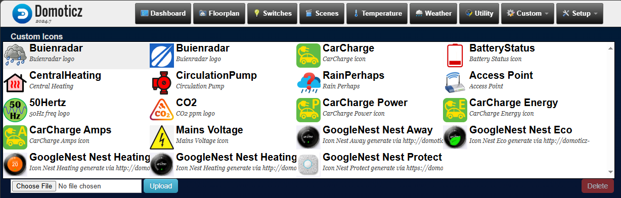

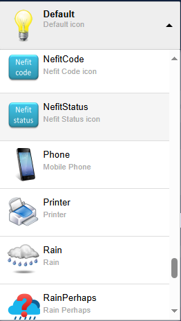

Just double checking: when I try to edit the icon of an existing switch, I cannot select the 'Plug' icon (2nd argument in icon.txt is the name, it is 'Plug' and I assume it should show up alphabetically:
240810 Plug not present.png (29.31 KiB) Viewed 2811 times
Also, I would expect it to show up in the Custom Icons screen:
Plug not present in custom icons.png (126.87 KiB) Viewed 2811 times
Pleae note that I have added several other icons 'manually' in the past (copy the 3 png files and edit switch_icons.txt), which is not the way to go. These icons do not show up in this Custom Icons screen.
Any suggestion for a further step?

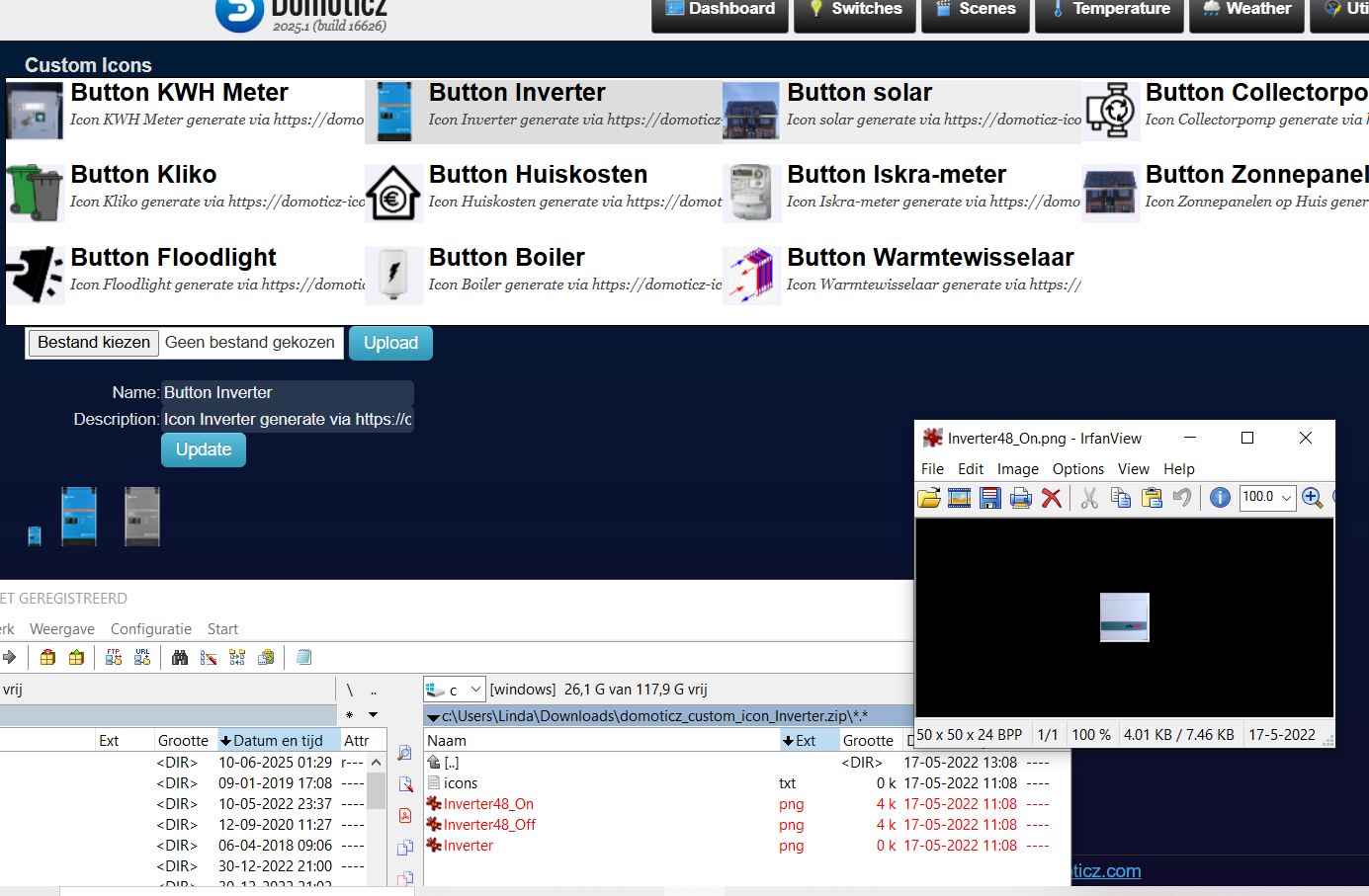

Hate to revive an older thread, but i also have trouble uploading a new icon on my Docker driven Domoticz.
As i was searching and trying to learn how to tackle this i noticed:
Version 2025.1 (May 5th 2025)
- Implemented: More default icons
First it didn't land wat this could implicate but after some digging i noticed one of my older, not currently used, custom icons had been replaced.
The icon in question is a custom icon i created called 'domoticz_custom_icon_Inverter.zip' ,a picture of my Solar-Edge inverter, but the icon that's being shown is not mine anymore. It looks like some sort of Victron gizmo..
Below a screenshot of the 'new' Inverter button and mine 'old' inverter button..
I removed the conflicting icon from the custom icons so now it's gone but the original problem remains..
All my icons have the zero bytes png-files and this has never been a problem and al still working fine.
