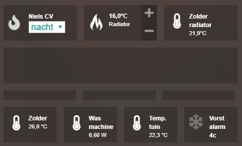

I tried, but my block stays empty
added:
//Configuring the OWM parameters
config['owm_api'] = 'my new api key';
config['owm_city'] = 'Rijswijk';
config['owm_name'] = '';
config['owm_country'] = 'nl';
config['owm_lang'] = 'nl';
config['owm_cnt'] = '3';
config['owm_min'] = true;
config['owm_days'] = true;
changed my column
var columns = {}
columns[1] = {}
columns[1]['blocks'] = [3,1248,1423,1303,1049,1018,1025,'currentweather_big_owm','weather_owm','455_1','982_1','457_1',1163,1285,1305,1250,calendars.fam]
columns[1]['width'] = 3;
etc.
added:
changed my column
var columns = {}
columns[1] = {}
etc.
- Naamloos.png (21.12 KiB) Viewed 3496 times

ok, both problems solved as you advised!
thanks lokonli!
it took some time before the api was operational...
thanks lokonli!
