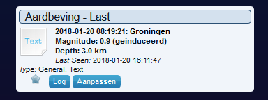

Because it was so easy to program and a hot topic in the news in the Netherlands, I created a python plugin which displays information about the most recent earthquake in the Netherlands. This device displays:
- Date and time
- City (with link to the exact location in Google maps)
- Magnitude and type (tectonic or induced)
- Depth
Still beta, but plugin is available at https://github.com/Xorfor/Domoticz-Last ... ake-Plugin

Funny to see. The created map is that the exact location?

Yes, the map points to the location of the earthquake, which is calculated by different stations.
