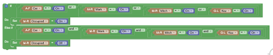

markjgabb
Posts: 142
Joined: Tuesday 24 January 2017 23:00
Domoticz version: 3.8153
Location: Australia
Re: blocky presence for many people
Post by markjgabb »
sorry for slow reply
this is the current blocky I use below
the occupancy switch just never changes to on
occupancy blocky.PNG (13.14 KiB) Viewed 2084 times

Posts: 550
Domoticz version: 4.10538
Post by pvm »
In the else part you use 'on' guess that should be 'off'
I would add an extra check to make sure when presence is on it does not switch on again
markjgabb
Posts: 142
Location: Australia
Post by markjgabb »
wow, i cant believe i missed that......seriously.....how the heck did i miss it had on set there.....works perfectly now, so the aditional check so chuck the entire set of or and one side and put an and box around it?
wow thanks...ive been staring at that for hours and never saw that

pvm
Posts: 550
Post by pvm »
If off and (p1 on or p2 on) etc
markjgabb
Posts: 142
Location: Australia
Post by markjgabb »
excelent...seem to be working now
thanks guys...still slapping myself for missing that one
