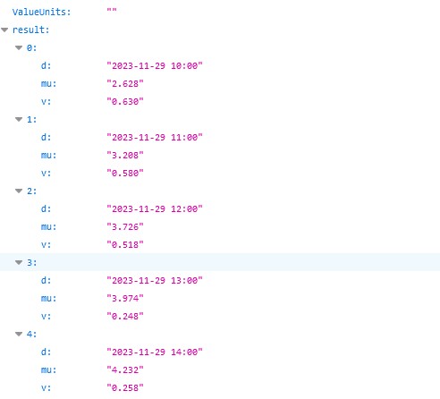

To get the hourly values using a JSON you can use
http://xxx.xxxx.xxx.xxx:8080/json.htm?type=command¶m=graph&sensor=counter&idx=IDX&range=day- waltervl

Those are the values I was looking for.
And you're right.
This gives me the information I wanted.

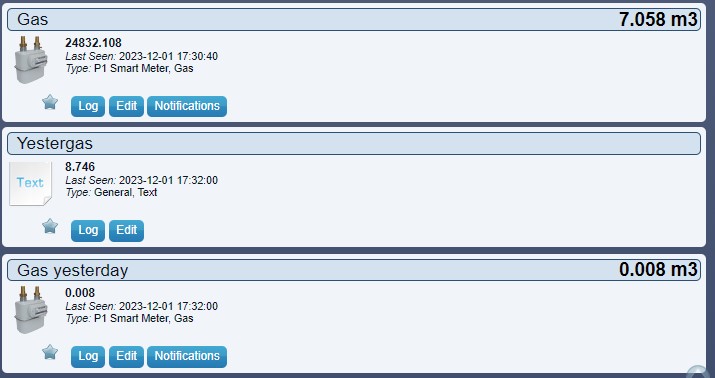

I did like this:
But now I am at a loss how to handle the Sensor update process.
I created a Gas dummy named: Gas yesterday and a text dummy named Yestergas.
Let's say I want to fetch value 1: like 24 hours before.
How do I update ?

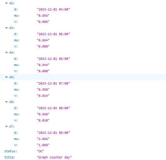

Remark: value 1: to 25: is never displayed, it starts with 3: or 5: and goes up and up like from 33: to 57: and onward.
The url put in a browser always starts at 0:
So why is it augmenting in a script.
First success: I am able to update the text dummy Yestergas with this one:
Maybe write some code to find the highest value and substract 24 and substitute that for the 44 in the example above?

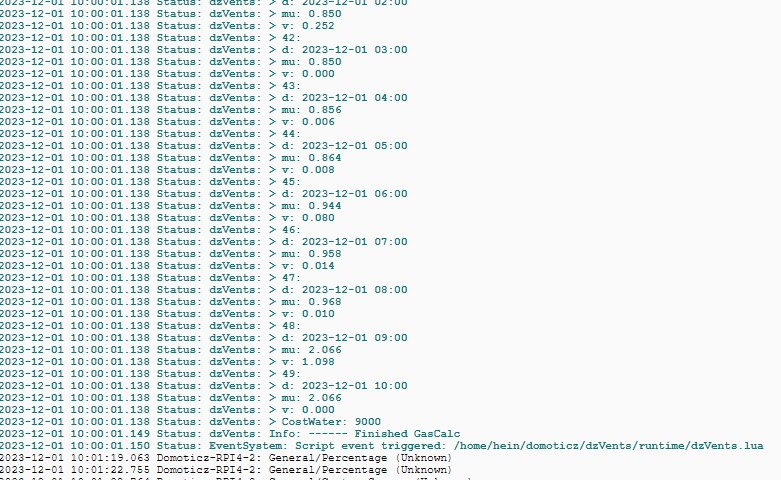

30 22:02:00.461 Status: dzVents: > mu: 10.308
2023-11-30 22:02:00.461 Status: dzVents: > d: 2023-11-30 21:00
2023-11-30 22:02:00.461 Status: dzVents: > 25:
2023-11-30 22:02:00.461 Status: dzVents: > v: 0.000
2023-11-30 22:02:00.461 Status: dzVents: > mu: 10.308
2023-11-30 22:02:00.461 Status: dzVents: > d: 2023-11-30 22:00
2023-11-30 22:02:00.461 Status: dzVents: > ValueQuantity:
2023-11-30 22:02:00.461 Status: dzVents: > CostEnergyR1: 800
2023-11-30 22:02:00.461 Status: dzVents: > ValueUnits:
2023-11-30 22:02:00.461 Status: dzVents: > DividerWater: 100.0
2023-11-30 22:02:00.461 Status: dzVents: > CostEnergyR2: 800
2023-11-30 22:02:00.461 Status: dzVents: > CostWater: 16473
2023-11-30 22:02:00.473 Status: dzVents: Info: ------ Finished GasCalc
2023-11-30 22:02:00.473 Error: dzVents: Error: (3.1.8) An error occurred when calling event handler GasCalc
2023-11-30 22:02:00.473 Error: dzVents: Error: (3.1.8) ...n/domoticz/scripts/dzVents/generated_scripts/GasCalc.lua:26: attempt to call a nil value (field 'updateSensor') Let's say I want to fetch value 1: like 24 hours before.
How do I update ?
domoticz.devices('Yestergas').updateText(item.json.result[44].mu)EDIT
Suggestions for another type of dummy than text?

Can you show the result of this request:
Your log is saying that item.json.result[1].Data is empty
http://192.168.1.1:8080/json.htm?type=command¶m=graph&sensor=counter&idx=16&range=day-

The log shows data as well as the json does
And the log:
It's working, however I was only able to catch it in a text file and I want to automate it to give me the value of 24 hours before now.
To be more precise: I'd like to catch the Gas consumtion at noon yesterday.
The mu that is connected with d: 2023-11-30 12:00 or maybe better d: 2023-11-30 12:00 just the d: and 12:00
2023-12-01 10:24:00.292 Status: dzVents: > 27:
2023-12-01 10:24:00.292 Status: dzVents: > d: 2023-11-30 12:00
2023-12-01 10:24:00.292 Status: dzVents: > mu: 3.528
2023-12-01 10:24:00.292 Status: dzVents: > v: 0.582Bugs bug me.

Please check the Dzvents documentation to select the correct update function for your type of device:
https://www.domoticz.com/wiki/DzVents:_ ... ipting#Gas
If it is a GAS device then it is updateGas()
The first hour in the list will be the currentHour X days ago, X being the number of days in your history.
So yesterdays value of the previous complete hour will be (X-1)*24
CurrentHour yesterday will be (X-1)*24+1
etc.
To pick out the mu value from the response you can use
item.json.result[(X-1)*24].mu

Tukker
- Posts: 673
- Joined: Sunday 01 November 2015 22:45
- Domoticz version: 2023.2
- Location: Twente
Re: DzVents script suggestions please
Thanks @willemd
The updateGas tip is what I needed.
Next problems
Here is the code:
and the output:
So the gas seems to have a need to be multiplied by 1000
Nice outcome: The list always seems to be ending at #49, so asking the #25 outcome should be ok.
Next problems
Here is the code:
domoticz.devices('Gas yesterday').updateGas(item.json.result[27].mu) domoticz.devices('Yestergas').updateText(item.json.result[27].mu)Nice outcome: The list always seems to be ending at #49, so asking the #25 outcome should be ok.

It is in the documentation:HvdW wrote: Friday 01 December 2023 17:37
updateGas(usage): Function. Usage in dm3 (liters).
#49 because you have your history setting at 2 days.
#25 will give you the current hour yesterday, which will be a full hour, so comparing this to the current hour total only makes sense at the end of the current hour.
Tukker
- Posts: 673
- Location: Twente
Re: DzVents script suggestions please [Solved]
Found the easy way out.HvdW wrote: Tuesday 28 November 2023 12:03 I want to write/copy a script that can display the usage at a given time, or at the current time yesterday and the days before.
In other words: Is my daily gas consumtion at noon more or less than yesterday at noon.
What I wanted to achieve is to know yesterdays values and display those.
Main question: what was the gas consumption at noon yesterday.
My simple approach now is to check and update every day at noon + 5 or so minutes because gas updates some minutes after the hour.
Here is the script:
timer = {'at 12:08'},
execute = function(domoticz, triggeredItem)
local gasconsumptiontoday = domoticz.devices('Gas').counterToday
domoticz.devices('Gas yesterday noon').updateGas((gasconsumptiontoday*1000))
domoticz.notify('Gasmeter ' .. gasconsumptiontoday, domoticz.PRIORITY_HIGH)
}Code: Select all
domoticz.devices('Gas yesterday noon').updateGas(domoticz.devices('Gas').counterToday*1000)
}Bugs bug me.
