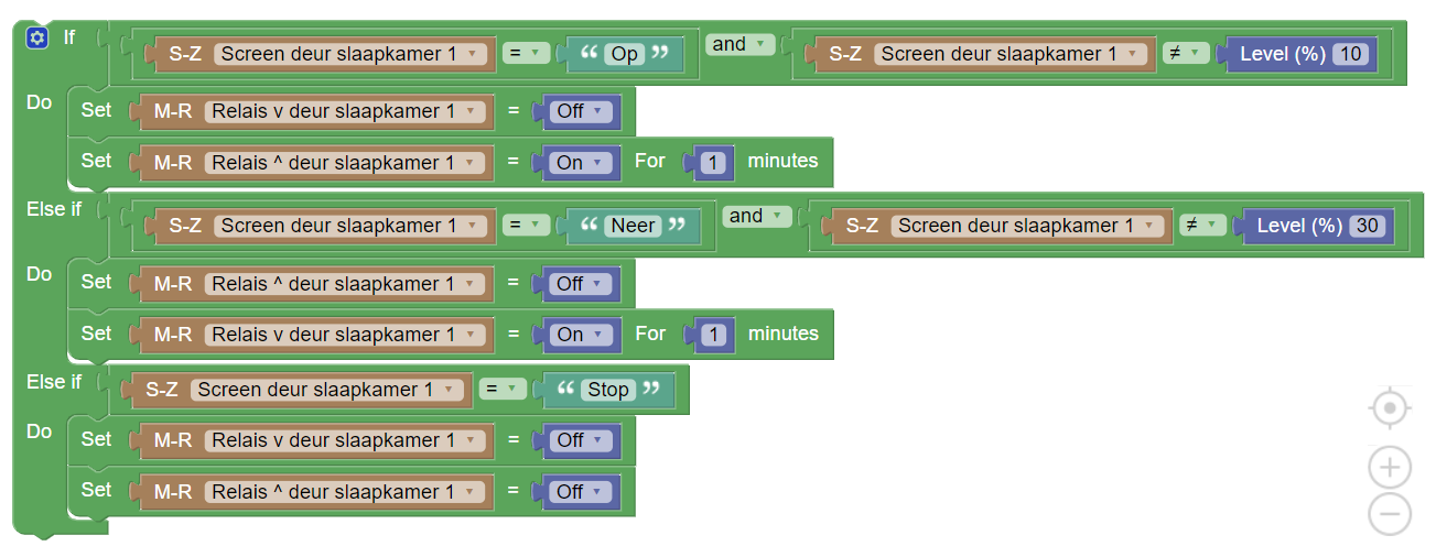

The scripts looks like:
Aantekening 2020-07-05 141552.png (111.19 KiB) Viewed 1297 times

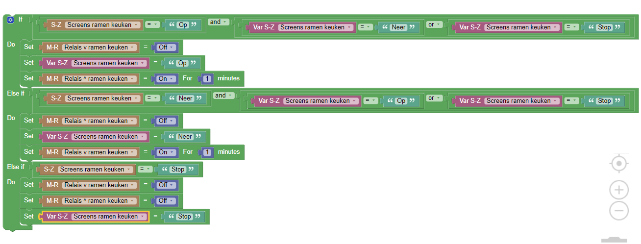

I also use this one:
Screens master.png (86.8 KiB) Viewed 1297 times
Re: Collecting multiple scripts in a single script
Jan Jansen wrote: Sunday 05 July 2020 14:11 Today I managed to convert a Blockly script to DzVents.
Not sure if this is what you mean but if the only difference between the screens is the number this should do it.
return
    on =
        devices =
            'Screen deur slaapkamer*',
    logging =
        level = domoticz.LOG_DEBUG, -- change to domoticz.LOG_ERROR when all ok
        marker = 'screens',
    execute = function(domoticz, switch)
        roomNumber = switch.name:sub(-1,-1) -- get the last char of the switchname
        if (switch.state == 'Op' and switch.level ~= '10') then
            domoticz.devices('Relais ^ deur slaapkamer ' .. roomNumber).switchOn().forMin(1)
            domoticz.devices('Relais v deur slaapkamer ' .. roomNumber).switchOff()
        elseif (switch.state == 'Neer' and switch.level ~= '30') then
            domoticz.devices('Relais ^ deur slaapkamer ' .. roomNumber).switchOff()
            domoticz.devices('Relais v deur slaapkamer ' .. roomNumber).switchOn().forMin(1)
        elseif (switch.state == 'Stop') then

I discovered that "switch.level ~= '10' " makes no sense. With "switch.level ~= '10' " I wanted to prevent an unnecessary next action if, for example, the 'Up' button is pressed a second time.
It can be solved with a user variable as done in the following Blockly script.
blockly screens ramen keuken.png (88.86 KiB) Viewed 1264 times
Is this possible in DzVents without a user variable?
Jan Jansen wrote: Sunday 05 July 2020 17:04 ...It can be solved with a user variable. Is this possible in dzVents without a user variable?
something like this ?

Jan Jansen
Posts: 229
Joined: Wednesday 30 April 2014 20:27
Domoticz version: Stable
Post by Jan Jansen »
waaren wrote: Sunday 05 July 2020 17:28
It is not the solution I was looking for, unfortunately. Using the Blockly script (including the user variable) it works as desired. When I press the 'Up' button on the selector switch, the screen goes up. However, this only happens if the previous position of the selector switch was 'Stop' or 'Down'.
