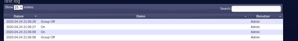

How do J_up and J_down behave if you change them to push On buttons ? (edit the devices on the switches tab)
sailmich
Posts: 245
Joined: Wednesday 17 February 2016 22:55
Location: Germany

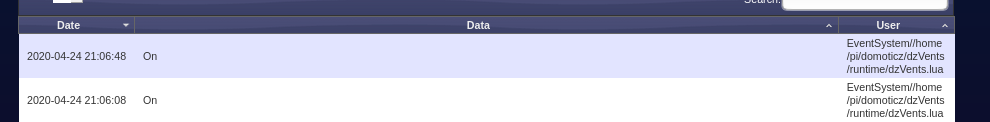

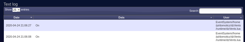

Re: Need help :Virtual blind percentage for eg. Velux
Post by sailmich »
On the remote server they still have 'on/off/GroupOff'. I changed them also on main domoticz and I got just 'on'. :D
As you can see MainJ_up.png got two times on signal, because I toggled the remote switch. But Vhoch didn't get the second from J_up.
sailmich wrote: Friday 24 April 2020 21:27 On the remote server they still have 'on/off/GroupOff'. I changed them also on main domoticz and I got just 'on'. :D
In one of the recent Beta's (build 11959) a commit was applied that prevents the log of identical states of switches. Could that be the reason?
sailmich
Posts: 245
Location: Germany
Post by sailmich »
waaren wrote: Friday 24 April 2020 23:09
I don't thing so. According to the domoticz log the remote process is already finish calculated before the next switch on signal is comming. But the process can't stop.
For better understanding the log for J_down with a second push.
