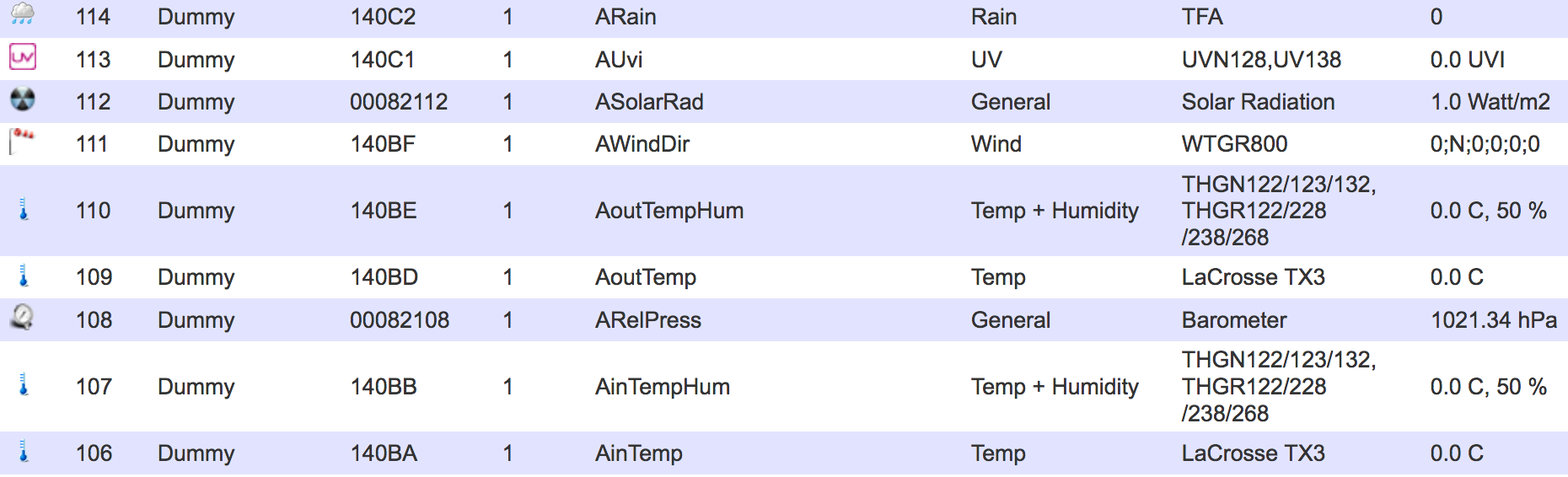

I am not 100% sure about what devices to create, for now I did this :
Screen Shot 2019-08-28 at 10.33.57.png (169.12 KiB) Viewed 8362 times

I would like to understand!
How to update the values ​​of different devices in domoticz
The values ​​are all in remarks
        --local wind = dz.devices('AWindDir')
        --local insideTemperature = dz.devices('AinTemp')
        --local insideTemperatureHumidity = dz.devices('AinTempHum')
        --local outsideTemperature = dz.devices('AoutTemp')
        --local outsideTemperatureHumidity = dz.devices('AoutTempHum')
        --local solarRadiation = dz.devices('ASolarRad')

Re: Get weather data from LAN based ObserverIP PWS
Doudy wrote: Thursday 17 October 2019 11:56 How to update the values ​​of different devices in domoticz
From the comments in the script:
-- Change devicenames below to reflect your names and uncomment the lines with the devices you defined.
-- You can also use idx but if you do, then don't use the surrounding quotes.
You can uncomment a line by removing the --
Also: you defined Daily-, Weekly-, Monthly- and YearlyRain as type Rain. The data from your weatherstation is not suited for this type of device.
That's why I asked in the script to define them as type Custom sensor and use mm for the x-as.
dailyRain Daily amount of rain in mm ( define as general Custom sensor with x-as mm )
weeklyRain Weekly amount of rain in mm ( define as general Custom sensor with x-as mm )
monthlyRain Monthly amount of rain in mm ( define as general Custom sensor with x-as mm )
yearlyRain Yearly amount of rain in mm ( define as general Custom sensor with x-as mm )
Post by Doudy »
But when i looking with
curl http://192.168.1.99/livedata.htm
I find a value for al this data (rainofdaily - rainofweekly - rainofmonthly - rainofyearly)
                        <tr>
                            <td bgcolor="#EDEFEF"><div class="item_1">Daily Rain</div></td>
                            <td bgcolor="#EDEFEF"><input name="rainofdaily"  type="text" class="item_2" style="WIDTH: 80px" value="0.30" maxlength="8">
                        <span id="rainofdaily_msg" class="errMsg0"></span></td>
                        </tr>
                        <tr>
                            <td bgcolor="#EDEFEF"><div class="item_1">Weekly Rain</div></td>
                            <td bgcolor="#EDEFEF"><input name="rainofweekly" type="text" class="item_2" style="WIDTH: 80px" value="15.90" maxlength="8">
                         <span id="rainofweekly_msg" class="errMsg0"></span></td>
                        </tr>
                        <tr>
                            <td bgcolor="#EDEFEF"><div class="item_1">Monthly Rain</div></td>
                            <td bgcolor="#EDEFEF"><input name="rainofmonthly" type="text" class="item_2" style="WIDTH: 80px" value="96.60" maxlength="8">
                         <span id="rainofmonthly_msg" class="errMsg0"></span></td>
                        </tr>
                        <tr>
                            <td bgcolor="#EDEFEF"><div class="item_1">Yearly Rain</div></td>
                            <td bgcolor="#EDEFEF"><input name="rainofyearly" type="text" class="item_2" style="WIDTH: 80px" value="602.70" maxlength="8">
                         <span id="rainofyearly_msg" class="errMsg0"></span></td>
                        </tr>
Post by Doudy »
It's going slowly
I have modified the rain devices at custom sensors
But the values = 0 mm
I have following :
        local rain = dz.devices('ARain')
        local dailyRain = dz.devices('ARainDaily')
        local weeklyRain = dz.devices('ARainWeekly')
        local monthlyRain = dz.devices('ARainMonthly')
        local yearlyRain = dz.devices('ARainYearly')
and
       local fieldNames = {    -- the commented fields are available in the html but not used in this script.
                                        rainofhourly='hourlyRainRate',
                                        rainofdaily='dailyRain',
                                        rainofweekly='weeklyRain',
                                        rainofmonthly='monthlyRain',
                                        rainofyearly='yearlyRain',
Log file :
