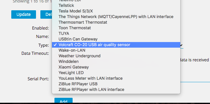

Re: Proposal for new device in Domoticz
You need to search for voltcraft.
HoogendoornJH
- Posts: 37
- Joined: Wednesday 31 July 2019 16:43
- Target OS: Windows
- Domoticz version: 12736
I am sorry Edwin, but I see neither Voltcraft nor air quality in the hardware list.
Aeotec Z-wave Gen5, RFXtrx433xl, Philips Hue Bridge, Davies Weather Station, Honeywell HGI/S80, AurAir CO2
- EdwinK
- Posts: 1820
- Domoticz version: BETA
- Location: Rhoon
You can find it there.
Maybe it's just in the beta version of Domoticz.

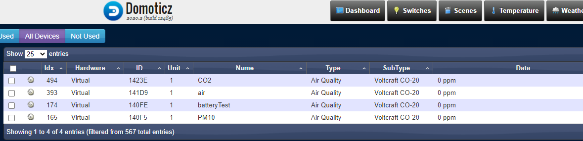

- waaren
- Posts: 6028
First add a 'Dummy (Does nothing, use for virtual switches') type hardware.HoogendoornJH wrote: Monday 19 October 2020 18:18 I am sorry Edwin, but I see neither Voltcraft nor air quality in the hardware list.
Push the highlighted [Create Virtual Sensor] on the just created hardware.
Select sensor type Air Quality name- and create it by pressing OK.
It will show up in the devices tab like the ones below
Mmm, strange Edwin. I upgraded to the latest version, but do not find the Voltcraft in the hardware list.EdwinK wrote: Monday 19 October 2020 18:54 You can find it there.

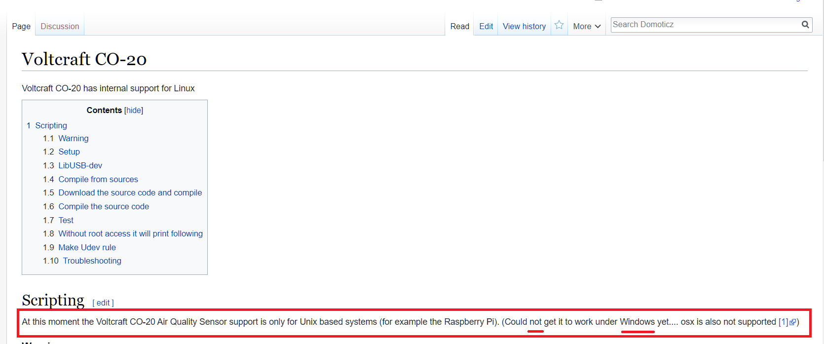

- waaren
- Posts: 6028
See below screenshot from the wikiHoogendoornJH wrote: Tuesday 20 October 2020 11:05 I performed your suggestions (did not find domoticz.js.gz), but still no Voltcraft.
HoogendoornJH
- Posts: 37
Ah, yes, what a pity. Anyhow, thanks for the support.
