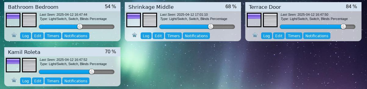

Re: Is it possible to add Shelly 2PM GEN 3 to Domoticz?
I use an old and not updated theme "machinon"
The switches are for shelly 2.5 which controls the blinds. These switches were added automatically.
These are switches for 4 blinds.
I would like to have such switches for shelly PM2 GEN 3 with NodeRed.
The question is how to do it? How to create a switch for a blind with the % indicator in domoticz?
I use % control
I use % control

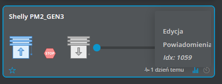

- Posts: 193
- Joined: Monday 14 November 2022 12:46
- Domoticz version: 2023.1
- Location: Poland

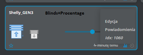

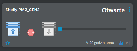

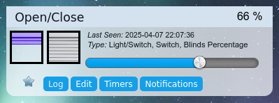

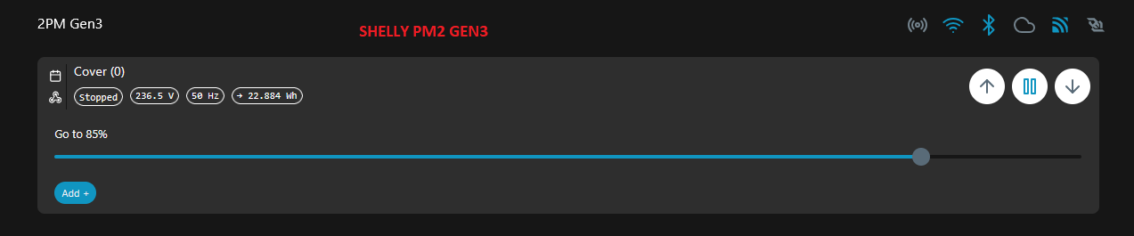

In the image from the previous post 4 switches for 4 blinds.
In the second image a screenshot from dashticz.
For me UP, DOWN and % control are enough, if there is still a possibility then STOP
I managed to create a blinds switch in Domoticz
- blinds.png (11.37 KiB) Viewed 1513 times

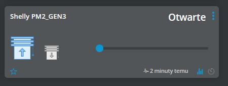

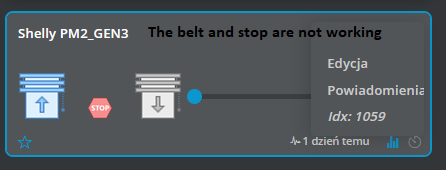

1. Control %% needed, necessary to control scenes in Domoticz because at different times of the day Domoticz sets the blinds to the indicated position.
2. STOP not needed if there are problems with it. Control in Dashticz up and down, however, stop is used to stop the blind in a given position by clicking UP or Down the blind will change direction, it will not stop. Currently, the stop in dashticz does not work and has never worked, so if it still does not work, I will not feel the problem, but if this functionality is possible, it is worth implementing it.
3. First image is Domoticz and Machinon theme - OK
Second image is dashticz - OK
So you can do it together with STOP there will be additional functionality.
- Zrzut ekranu 2025-04-08 185938.png (12.88 KiB) Viewed 1420 times
- Zrzut ekranu 2025-04-08 194046.png (23.79 KiB) Viewed 1420 times

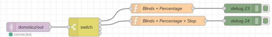

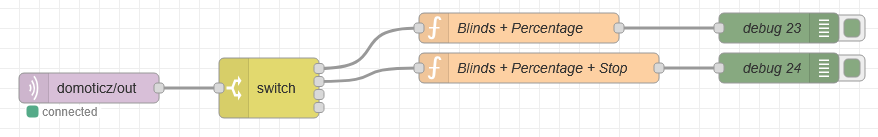

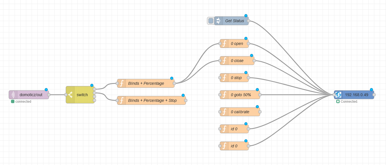

As promised, I created a simple flow for your "Blind Switches"
See below:
I collected the data from the Domoticz Switches with MQTT (topic domoticz/out). You have to configure the MQTT node yourself.
This data goes to a "Switch" node, which has been prepared for 4 "Blind Switches". Edit this node and insert your own Domoticz indexes for the various "Blind Switches"
I prepared 2 "Function"nodes,(1 for Blinds + Percentage" and a 2nd for the extra STOP Button)
If this gives the correct response, connect the output of that Function node to the correct Shelly node and test.
Please find the flow below and let me know, if this part works.
See below:

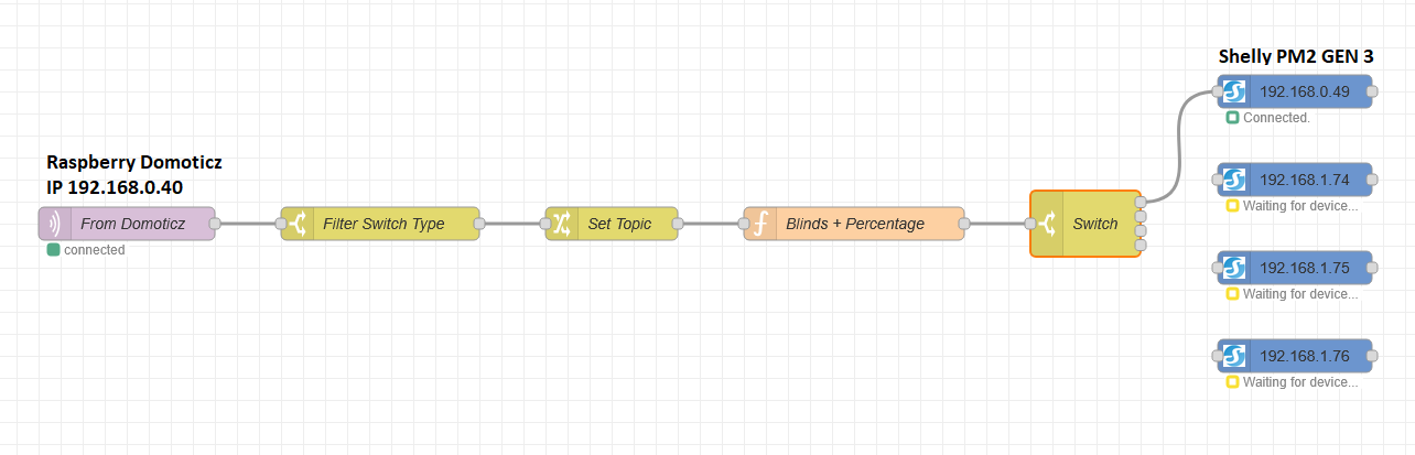

- Posts: 193
- Location: Poland

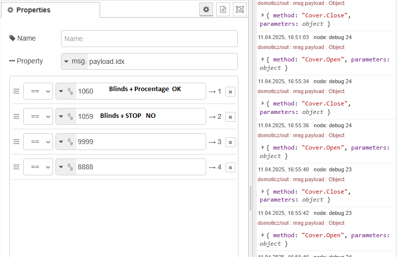

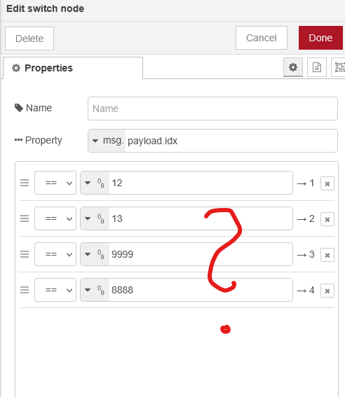

I edited the domoticz node - I put the IP of my Raspberry in it and the connection is there.
Now the question is where do I enter the IDX of my roller shutter switch?
In the switch node or in Blinds + Procentage

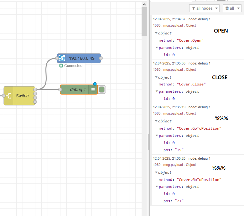

- FireWizard
- Posts: 1895
- Location: Voorthuizen (NL)
Hello @Daro1993,
I created 2 different "Function" nodes.
The first one is called "Blinds + Percentage", which is intended, if you choose to use a switch with only "Open", "Closed" and a slider for the percentage.
The second "Function"node, called "Blinds + Percentage + Stop" is an extended version version of the first one.
It is intended, if you choose to use a switch with "Open", "Closed", a slider for the percentage and the additional STOP button.
So, if you choose for your all 4 Widget.to use the "Open", "Closed", a slider for the percentage and the additional STOP button as your Switch, you should delete the "Blinds + Percentage" "Function" node and to replace it by a copy of the "Blinds + Percentage + Stop" node.

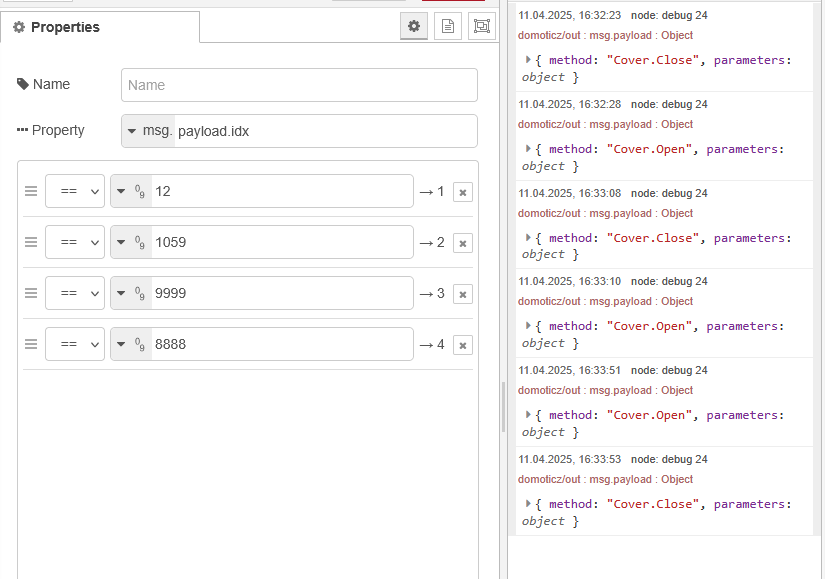

You asked:
As your widget (Open, Stop, Closed and a slider) has Idx number 1059, replace in the "Switch" node number 13 with 1059.
This means that all MQTT output from the Switch with Idx 1059 goes to the second (2) output of the "Switch" node.
If you have connected the correct "Function" node to output 2 you can check if you receive the correct values .
if so, connect the Shelly node and check the relays or the Blinds,
Let me know the result.
You asked:
In my previous post, I said:Now the question is where do I enter the IdX of my roller shutter switch?
So, in your case.This data goes to a "Switch" node, which has been prepared for 4 "Blind Switches". Edit this node and insert your own Domoticz indexes for the various "Blind Switches"

I did as you wrote and provided the IDX.

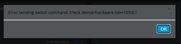

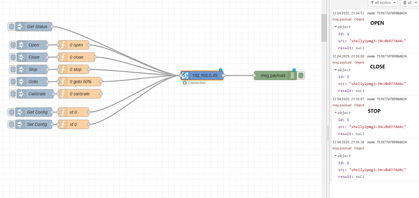

2. STOP doesn't work either - there's some error in Domoticz: Top works - ok
Bottom works ok
1. The % bar doesn't work, I click anywhere on the % bar and it doesn't work in dodmoticz - it doesn't change place.2. STOP doesn't work either - there's some error in Domoticz: Top works - ok
Bottom works ok
- Posts: 193
- Location: Poland
OK I HAVE SOME FINDINGS:
In the first column I added a switch up, down, percentage bar and everything works - ok The second column where the top is a large percentage and STOP does not work correctly. Only the top and bottom work.
STOP - ERROR as above.
The Percentage bar cannot be changed, it does not work.
I hope you know what I mean.
In general, the first column works fine, data from Domoticz to NodeRed goes if I click up, down and on the percentage bar.
Now how to connect it with the flow from Schelly??
- IDX.png (18.29 KiB) Viewed 1178 times

Hello @Daro1003,
If I understand you correctly, a "switch widget" In Domoticz with a "Open", 'Closed" and a "Percentage" slider
works correctly. However the the percentage slider I do not see that in your Debug field.
It should show: method: "Cover.GoToPosition".
If you use the widget with the "STOP" button, only the "Open" and "Closed" buttons works and the slider and STOP button does not work.
In my case, it works fine and it shows: method: "Cover.Stop"
Also method: "Cover.GoToPosition" works correct, but the slider in the widget is too long (see that other topic)
I'm afraid, that it does not work for you, is related to the Machinon theme. I never used that theme and I saw, the latest update has been published August 2020. So you may ask @DewGew, if he can confirm the problem you have.
For the moment, I suggest to take the working widget and so the Function node with "Blinds +Percentage". Your IDX 1060.
It should work.
Let me know
I wrote already:Now how to connect it with the flow from Schelly??
So connect the input of your Shelly node (Check that you have the right one) to the output of the "Function" node (instead of the Debug nodes).If you have connected the correct "Function" node to output 2 you can check if you receive the correct values .
if so, connect the Shelly node and check the relays or the Blinds.
It should work.
Let me know

- FireWizard
- Posts: 1895

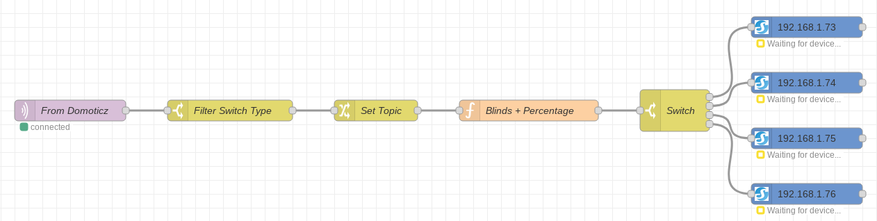

Hello @Daro1003
This was not the intended use of the flow and I can assume that it sometimes works as you described.
Actually my flow acts as a trigger to the "Open" and "Closed" test nodes, that you used before.
So this is not the way to go. Delete everything, what you created so far.
I looked to your first posts again and I concluded that we should use 4 "Blinds Percentage"Switches as shown on the next picture.
I translated the Polish text as good as possible to English, except one, as Google Translate could not help me with that
As the other Switch with the STOP button does not work, we skip that one.
As you have shown me 4 switches, I assume you have 4 different Shelly 2PM Gen 3 units.
Mind the pair between the Domoticz Switch and the Shelly device.
In my example the Bathroom Bedroom has IDX 12, the Shrinkage Middle has IDX 13, the Terace Door 14 and the Kamil Roleta has IDX 15.
I created one new flow, that is able to handle all 4 switches
Import this flow and do the following:
1. MQTT input node, called "From Domoticz" >> Insert you own MQTT configuration (as you did before)
2. "Switch" node, called "Filter Switch Type" >> No action required. so do not touch.
3. "Change"node, called "Set Topic" >> No action required. so do not touch.
4. "Function"node, called "Blinds + Percentage" >> No action required. so do not touch.
5. "Switch" node, called "Switch" >> Insert your own Domoticz IDX's numbers, instead of my number 12, 13, 14 and 15.
6. "Shelly" nodes >> Insert your own IP address of your Shelly devices, so that they show "Connected".
The everything should work.
Please find the flow below:
Test this and let me know

I connected one piece of shelly PM2 GEN 3 to one roller blind and I am testing the rest of the roller blinds are still working on the old 2.5 that are breaking down and which I would like to replace with something else.
I am asking you for a flow for tests for one shelly PM2 GEN 3 if everything works, I will continue to buy new shelly PM2 GEN 3 controllers.
No NoFireWizard wrote: ↑Saturday 12 April 2025 19:29 As you have shown me 4 switches, I assume you have 4 different Shelly 2PM Gen 3 units.
I have 14 pieces of old shelly 2.5 that are breaking down and I showed the switches from these shelly 2.5.
I have one piece of shelly PM2 GEN3 - 1 piece for tests / operation tests.

I did:
Top - works ok, I click, goes up - I can't stop it
Bottom - works ok, I click, goes down - I can't stop it
Percentage bar - the white blind is set to the designated position.
The only thing missing is for the blind position bar to be updated, i.e. I set the blind with the local switch and the percentage bar is set like the blind.
In the shelly options, this bar is set like the blind. So it shows the blind status in domoticz, unfortunately not. Is it possible to do this?
And it works

Hello @Daro1003,
Good that it works
If you want that, you can delete the Switches in Domoticz, that are not needed.
You can also delete the Shelly Nodes, currently showing "Waiting for device...", as you don't need them for now.
First, I decided to make the connection from Domoticz (Switch) to Node-RED and to the Shelly unit functional.
Now it is time for the Shelly to Domoticz function.
I assume you have a physical Switch, that also controls your blinds.
But Shelly has also an app on your phone or tablet, which can be used to control the device.
Do you use that as well?
In order to update the Domoticz Switch, I need to know, what the output is, if you press the button of the 'Insert" node, marked "Get Status"
See your post of April 7, 07:38 h.
Do you want more Status information, e.g. Temperature?
Can you send me that?
Good that it works
The "Blinds Percentage" switch does not have that possibility and the only switch that has the "STOP" function does not work in your Machinon Theme and in the default theme the slider bar is too long. So we will not use that.I can't stop it
I know, but that is the next step.The only thing missing is for the blind position bar to be updated, i.e. I set the blind with the local switch and the percentage bar is set like the blind.

FireWizard wrote: ↑Saturday 12 April 2025 20:57
YES
I do not use the application for control.FireWizard wrote: ↑Saturday 12 April 2025 20:57
P.S
The application in shelly 2.5 did not work simultaneously with Domoticz.
If Domoticz worked, there was no cloud operation and I never used the application.
If Domoticz worked with shelly 2.5, the application only worked on the local IP address.

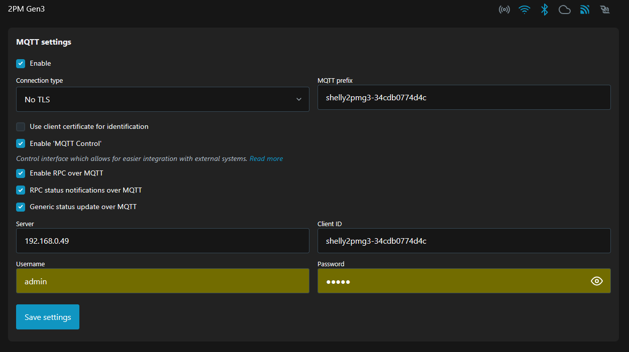

Question: Should the MQTT window in schelly be configured? If so, how?
Is this the data you are talking about??FireWizard wrote: ↑Saturday 12 April 2025 20:57 In order to update the Domoticz Switch, I need to know, what the output is, if you press the button of the 'Insert" node, marked "Get Status"
Temperature data - needed because I currently have a fan installed to cool Shelly 2.5, thanks to the temperature data I have blockly in domoticz which controls the fan based on the temperature given by Shelly.
I have noticed a strange behavior of shelly PM2GEN3
If I go to the shelly page 192.168.0.49, NodeRed disconnects from shelly - I have to restart to reconnect shelly - NodeRed.
But not every time.
