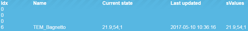

I got a similar issue....
the problem is a fake device... and cannot understans what are these :(
they are not available in the device tab, not in the used ones...
do I have to remove them straight from the db?!
