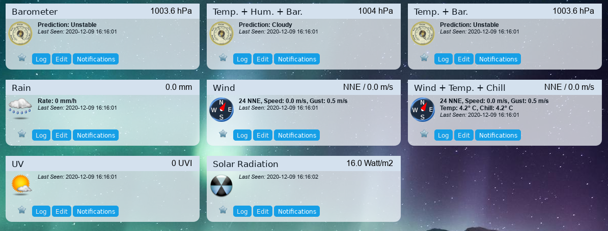

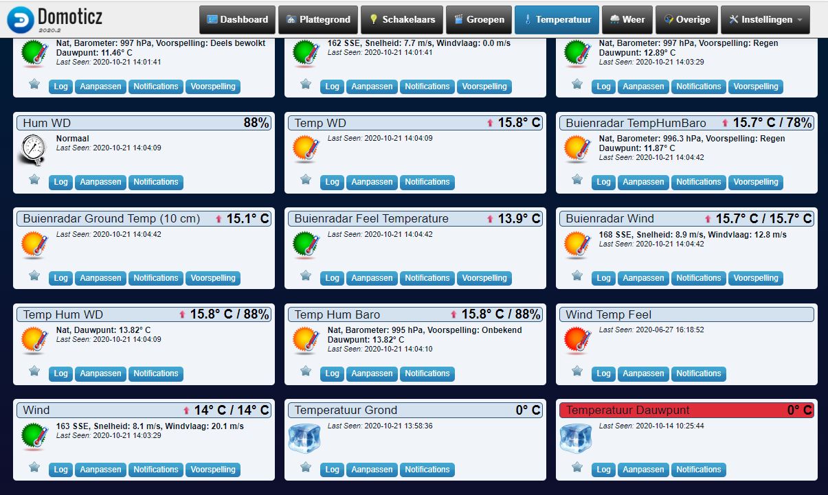

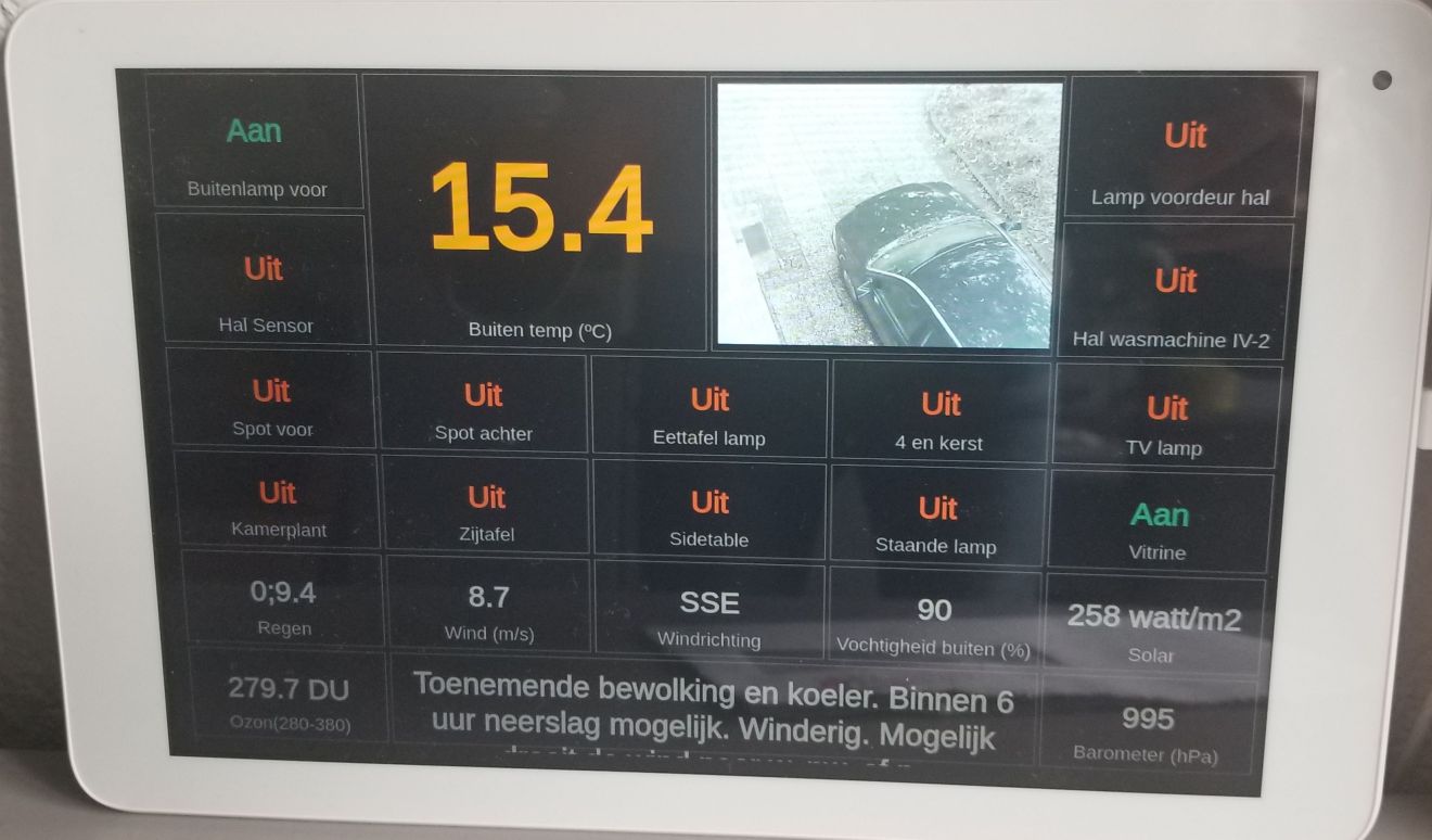

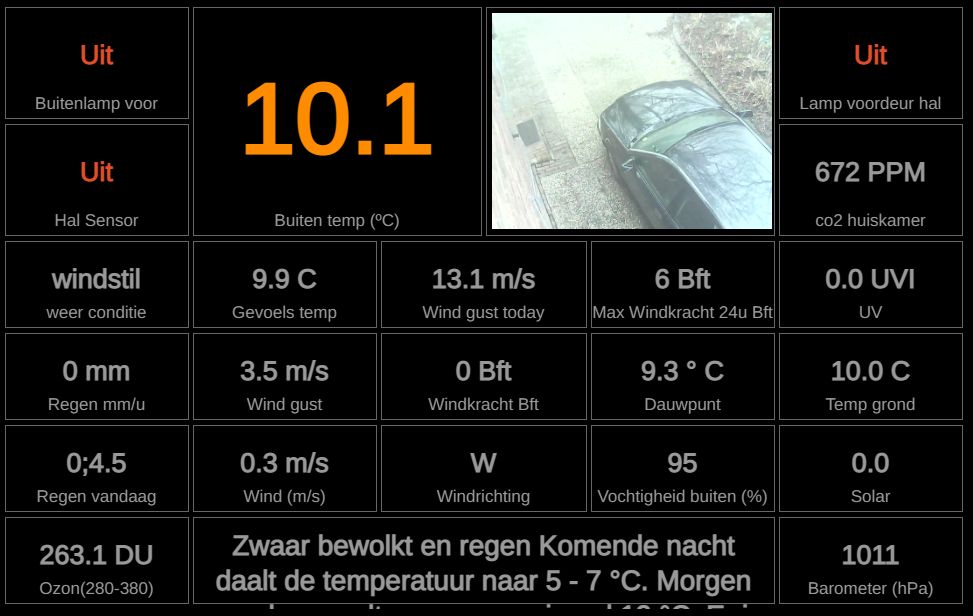

Also I have values from Darksky / Buienradar /Open Weather Maps sensors see att 2 and 3
(But I prefere my own values from my weatherstation Davis VP2 and software WeatherDisplay more precisely, sensors with ".." WD on it)
For other values (see below) I did not find any scripts to get them in sensors (or I did not understand :lol:) however I studied/searched for months #-o

The first sensor you want to update is the "Rain" sensor.
Rain
The rain sensor will show the amount of rain fallen in mm and a rate in mm/h. You can send
{"command":"udevice", "idx":1234, "svalue":"rt;fl"}
where rt is the rate in mm/h fl is amount of rain fallen. PLEASE NOTE that fl is cumulative, so if the value is 3 mm and you send 2 mm, it will be 5 mm.
It is unclear for me, how you receive the value, but lets assume rate msg.payload.rate = 0 and the amount of rain fallen msg.payload.fallen= 2
Let us also assume that this are numbers and not strings.
The command you have to send to Domoticz is:
msg.payload = {"command":"udevice","idx":519,"nvalue":0,"svalue":msg.payload.rate.toString() + ";" + msg.payload.fallen.toString()};
return msg;
If it are already strings, then you should remove the .toString() function.
2.
Second sensor is the UV sensor.
UV
The UV sensor will show just that in the UV Index. You can add digits after the decimal if needed.
{"command":"udevice", "idx":1234, "svalue":"uv;0"}
where uv is the uv index.
I don't know where the UV value comes from but let's assume it is a number and is available in msg.payload.uv.
msg.payload = {"command":"udevice","idx":516,"nvalue":0,"svalue":msg.payload.uv.toString() + ";" + "0"};
return msg;
or at the end ";0" instead of ";" + "0".
3.
Third sensor is the Solar radiation sensor.
Solar radiation
The solar radiation sensor will show just that in W/m2. You can add digits after the decimal if needed.
{"command":"udevice", "idx":1234, "svalue":"3.45"}
I don't know where the Solar value comes from but let's assume it is a number and is available in msg.payload.solar and is a number.
msg.payload = {"command":"udevice","idx":394,"nvalue":0,"svalue":msg.payload.solar.toString()};
return msg;

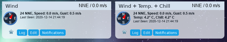

4.
Fourth sensor is the Wind sensor.
Wind
The wind sensor will show wind direction, velocity and gust speed. You can add digits after the decimal if needed.
{"command":"udevice", "idx":1234, "svalue":"an;dr;sp;gu;tm;ch"}
where an and dr are used to show the angle and wind direction, where an is the angle (can be any number and my have digits after the decimal) and dr is the direction. You can use N, NE, E, SE, S, SW, W and NW. sp is the speed in 0.1 m/s and gu is the gust speed in 0.1 m/s.
You can program it yourself, as we have 6 parameters and I don't know, where they come from.
If you can provide that information I can support you, but the principal is the same.
For temperature and humidity, I suggest you have a look at: viewtopic.php?f=34&t=32414&p=261548#p261548
Remember, you can not invent your own sensor devices, such as: winddir, windspeed+winddir, avgbearing and the svalue has to comply with the format in https://piandmore.wordpress.com/2019/02 ... -domoticz/
If you need more I'm happy to support you,

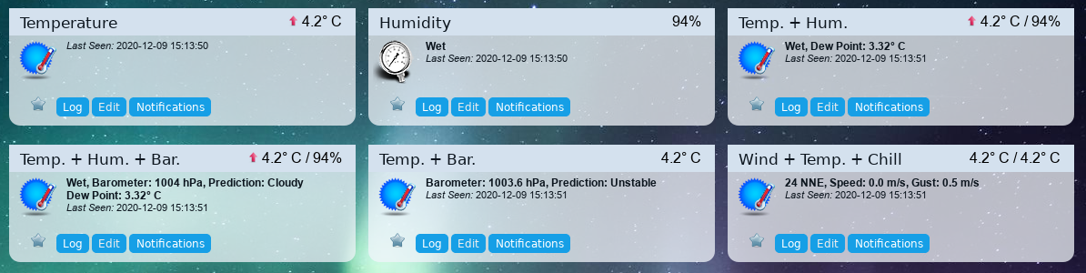

As I noticed that more users have difficulties to send data, received by e.g. MQTT or a HTTP request from Node Red to Domoticz, I have decided to make a kind of model. As not all weather stations present the same format and not all type of sensors are present the input may vary.
Domoticz supports the following weather sensors:
1. Temperature (will be presented under the Temperature tab).
2. Humidity (will be presented under the Temperature tab).
3. Barometer (will be presented under the Weather tab).
4. Combined sensors Temperature and Humidity (will be presented under the Temperature tab).
5. Combined sensors Temperature and Humidity and Barometer (will be presented under the Temperature tab AND under the Weather tab).
6. Combined sensors Temperature and Barometer (will be presented under the Temperature tab AND under the Weather tab).
7. Rain (will be presented under the Weather tab).
8. Wind (will be presented under the Weather tab).
9. Combined sensors Wind and Temperature and Chill (will be presented under the Temperature tab AND under the Weather tab).
10. UV (will be presented under the Weather tab).
11. Solar radiation (will be presented under the Weather tab).

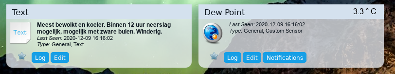

As extra I have also included:
12. Text sensor (will be presented under the Utility tab).
13. Custom sensor (will be presented under the Utility tab).

msg1.payload = {"command":"udevice", "idx":30, "svalue":tm};
msg2.payload = {"command":"udevice", "idx":31, "nvalue":parseInt(hu), "svalue":lv};
msg3.payload = {"command":"udevice", "idx":32, "svalue":ba + ";" + pr};
msg4.payload = {"command":"udevice", "idx":33, "svalue":tm + ";" + hu + ";" + lv};
msg5.payload = {"command":"udevice", "idx":34, "svalue":tm + ";" + hu + ";" + lv + ";" + ba + ";" + pr};
msg6.payload = {"command":"udevice", "idx":35, "svalue":tm + ";" + ba + ";" + pr};
msg7.payload = {"command":"udevice", "idx":36, "svalue":rt + ";" + fl};
msg8.payload = {"command":"udevice", "idx":37, "svalue":an + ";" + dr + ";" + sp + ";" + gu + ";" + tm + ";" + ch};
msg9.payload = {"command":"udevice", "idx":38, "svalue":an + ";" + dr + ";" + sp + ";" + gu + ";" + tm + ";" + ch};
msg10.payload = {"command":"udevice", "idx":39, "svalue":uv + ";" + "0"};
msg11.payload = {"command":"udevice", "idx":40, "svalue":sr};
msg12.payload = {"command":"udevice", "idx":41, "svalue":txt};
msg13.payload = {"command":"udevice", "idx":42, "svalue":dp};
return [[msg1,msg2,msg3,msg4,msg5,msg6,msg7,msg8,msg9,msg10,msg11,msg12,msg13]];

@FireWizard !!
Sorry for a late reply but: you made my day !, week!, months! !!! So long strugling and this was the solution at all.
Had to change only idx because of existing ones but after that 'appeltje, eitje' as we say.
Amazing !
Some questions:
msg8.payload = {"command":"udevice", "idx":612, "svalue":an + ";" + dr + ";" + sp + ";" + gu + ";" + tm + ";" + ch};
msg9.payload = {"command":"udevice", "idx":613, "svalue":an + ";" + dr + ";" + sp + ";" + gu + ";" + tm + ";" + ch};
what's the difference between those ?
can I use msg9.payload for only gust (+gu) I tried with
msg9.payload = {"command":"udevice", "idx":613, "svalue":dr + ";" + sp + ";" + gu};
but gives error / no value
or how to destilate only 'gust' for a sensor ?
and (but very small issue)

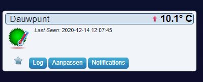

var dp = msg.payload.dew.toString(); // dew point
gives value in a 'temp' and 'custom' sensor and zero (0) in the original dew sensor from domoticz:
14-12-2020 12:04:25node: df461126.8efed
msg.payload : Object
{ command: "udevice", idx: 639, svalue: "10.1" }
(see att.)
Thanks so much again, no more headaches/sleepless nights ;-)
dew zero.jpg (10.52 KiB) Viewed 6558 times
As you already noticed, the commands are exactly identical. However the difference is the virtual sensor, to which this data is sent to.
msg8 is sent to a sensor of the type "Wind", while
msg9 is sent to a sensor of type "Wind+Temperature+Chill"
You will see this at: https://piandmore.wordpress.com/2019/02 ... -domoticz/
The wind+temperature+chill sensor uses the same command as the wind sensor except in this case the tm (temperature, you can not use digits after the decimal) and ch (chill temperature, you can not use digits after the decimal) are shown.
Contrary with what has been written above, you can use digits after the decimal for both temperature and chill.
See below:

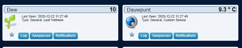

with this
msg15.payload = { command: "udevice", idx: 639, nvalue: parseInt(10.1) };
dew sensor always keeps on '10' while a custom sernsor has the value (see att)
if no value in
parseInt(10.1)
sensor keeps empty
how to get the value in official 'dew'sensor from domoticz ?
Thanks again for help !

with this
Code:
if no value in
I assume, that the sensor with IDX 639 is the "Leaf Wetness" sensor (called "Dew")
This sensor is populated by msg15.command with a fixed value of 10 (parseInt(10.1)
The Custom Sensor, which I created as an example of msg13,payload, looks like:
Feel free to replace dp with msg.payload.dew.toString().
Be aware, that in case of the "Leaf wetness" sensor you have to send the numerical value as nvalue, while in case of a custom sensor, you have to send the value as a string to svalue.
The custom sensor in Domoticz accepts decimals, while the leaf wetness sensor does not accept decimals (therefore we us parseInt)
So if you want to have the dew point in the leaf wetness sensor, you should send:
msg15.payload = { command: "udevice", idx: 639, nvalue: parseInt(dp) };
or
msg15.payload = { command: "udevice", idx: 639, nvalue: parseInt (msg.payload.dew) };
Something else.
I'm not a biological specialist, a specialist in plant diseases or a meteorological specialist, but I think that the dew point is not the same as leaf wetness . You call it the official dew sensor of Domoticz, but I do not believe that was the intention.
From Wikipedia:
The dew point is the temperature to which air must be cooled to become saturated with water vapor. When cooled further, the airborne water vapor will condense to form liquid water (dew). When air cools to its dew point through contact with a surface that is colder than the air, water will condense on the surface.
So this is a "Temperature".
Leaf wetness is a meteorological parameter that describes the amount of dew and precipitation left on surfaces. It is used for monitoring leaf moisture for agricultural purposes, such as fungus and disease control, for control of irrigation systems, and for detection of fog and dew conditions, and early detection of rainfall.
Leaf wetness duration is mostly measured 2m above the ground.
The Unit: ‘minutes per hour’.
It is up to you, of course, if you want to misuse the "leaf wetness" sensor for the dew point.
