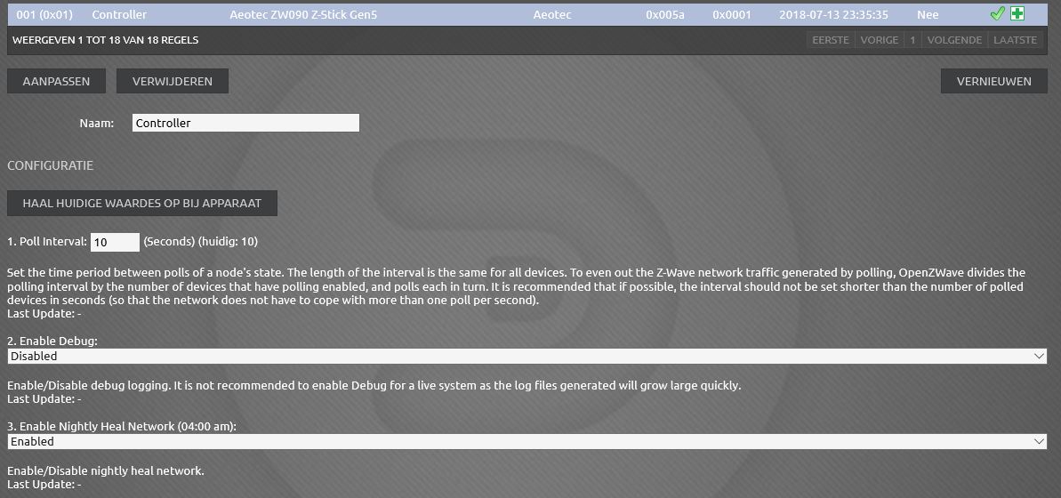

Same here... For this I do a planned restore health every night.

Sorry, I was kinda busy...
You can do that here:
No problem, I found the setting, I thought first it was going to be on each node.
