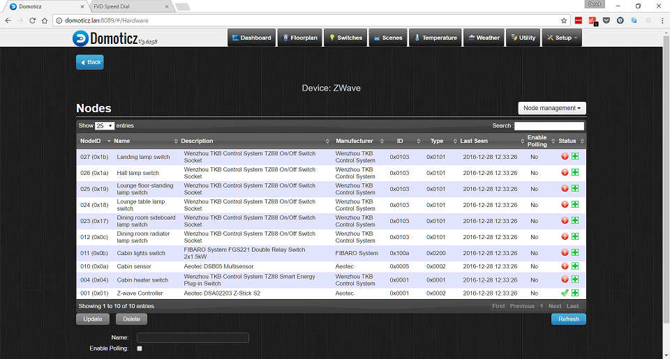

I woke up this morning to find that my Domoticz system wasn't functioning properly. On investigation, it appears that ALL Z-wave nodes, excluding the Z-Stick S2 controller, are reported as being dead. I've tried rebooting the system and it still shows everything as dead. Doing a network heal doesn't seem to do anything either. Screens attached and log file output below.
Any ideas appreciated as, right now, my whole system appears unusable.

Have you tried shutdown and power off/on instead of reboot?

Egregius wrote:Have you tried shutdown and power off/on instead of reboot?
Yes. It made no difference sadly.

And the 'has node failed' command in OZWCP?

Egregius wrote:And the 'has node failed' command in OZWCP?
I just get something like:
2016-12-28 15:39:36.696 Error, Node010, WARNING: node revived

And node 10 stayed dead? Or is it back alive?

Egregius wrote:And node 10 stayed dead? Or is it back alive?
Still dead - same as all the other nodes.

Well, if that doesn't help, and also clean shutdown poweroff/on doesn't help I would hard reset the controller and all nodes.
Then include them one by one again. After all it's only 9 nodes. Not such a big deal.

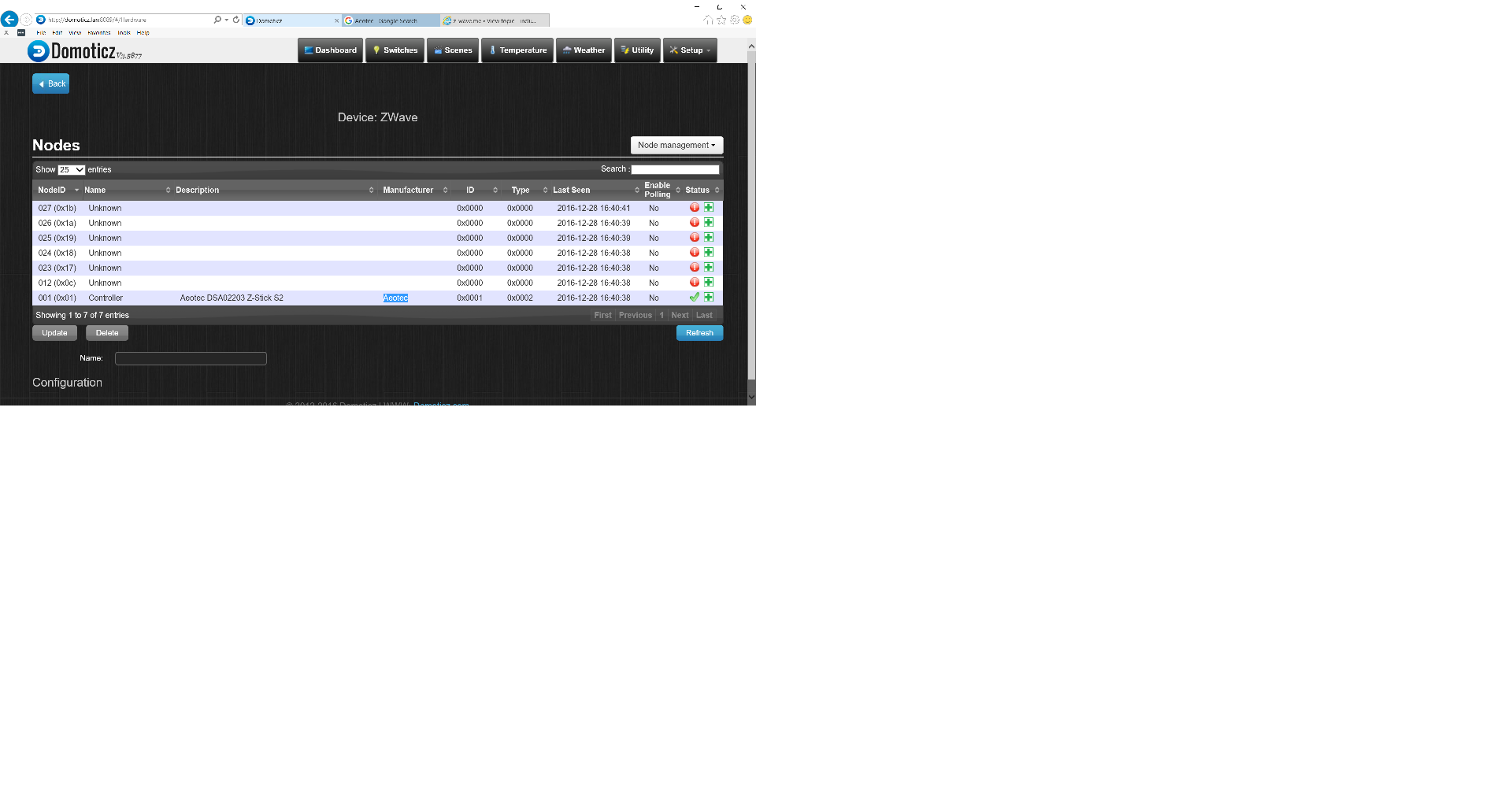

Hmmm. I've done a factory reset and even firmware upgrade of the Z-Stick. I've also now done a fresh install of Domoticz from scratch. I've re-associated some of the nodes with the Z-stick again (but taking the Z-stick to them and pushing the button, etc.). When plugged back into the Raspberry Pi and Domoticz is started I still get the same issue (see image)

2016-12-28 16:49:34.196 Info, Node012, WARNING: ZW_SEND_DATA failed. No ACK received - device may be asleep.
2016-12-28 16:49:34.198 Warning, Node012, WARNING: Device is not a sleeping node.
2016-12-28 16:49:34.200 Error, Node012, ERROR: node presumed dead
2016-12-28 16:49:34.201 Always,
2016-12-28 16:49:34.203 Always, Dumping queued log messages
2016-12-28 16:49:34.204 Always,
2016-12-28 16:49:34.207 Always,
2016-12-28 16:49:34.208 Always, End of queued log message dump
2016-12-28 16:49:34.209 Always,
2016-12-28 16:49:34.211 Warning, CheckCompletedNodeQueries m_allNodesQueried=0 m_awakeNodesQueried=0
2016-12-28 16:49:34.212 Warning, CheckCompletedNodeQueries all=0, deadFound=1 sleepingOnly=0
2016-12-28 16:49:34.213 Info, Node012, QueryStageRetry stage Probe requested stage Probe max 3 retries 2 pending 1
2016-12-28 16:49:34.215 Detail, Node001,   Expected callbackId was received
2016-12-28 16:49:34.216 Detail, Node001,   Expected reply was received
2016-12-28 16:49:34.218 Detail, Node001,   Message transaction complete
2016-12-28 16:49:34.219 Detail,
2016-12-28 16:49:34.221 Detail, Node012, Removing current message
2016-12-28 16:49:34.222 Detail, Node012, Notification: Notification - NoOperation
2016-12-28 16:49:34.224 Detail, Node012, Notification: Notification - Node Dead
2016-12-28 16:49:34.232 Detail, Node023, Query Stage Complete (Probe)
2016-12-28 16:49:34.233 Detail, Node023, AdvanceQueries queryPending=0 queryRetries=2 queryStage=Probe live=1
2016-12-28 16:49:34.234 Detail, Node023, QueryStage_Probe
2016-12-28 16:49:34.236 Info, Node023, NoOperation::Set - Routing=true
2016-12-28 16:49:34.238 Detail, Node023, Queuing (NoOp) NoOperation_Set (Node=23): 0x01, 0x09, 0x00, 0x13, 0x17, 0x02, 0x00, 0x00, 0x25, 0x29, 0xfc
2016-12-28 16:49:34.243 Detail, Node023, Queuing (Query) Query Stage Complete (Probe)
2016-12-28 16:49:34.245 Detail,
2016-12-28 16:49:34.246 Info, Node023, Sending (NoOp) message (Callback ID=0x29, Expected Reply=0x13) - NoOperation_Set (Node=23): 0x01, 0x09, 0x00, 0x13, 0x17, 0x02, 0x00, 0x00, 0x25, 0x29, 0xfc
2016-12-28 16:49:34.254 Detail, Node023,   Received: 0x01, 0x04, 0x01, 0x13, 0x01, 0xe8
2016-12-28 16:49:34.256 Detail, Node023,   ZW_SEND_DATA delivered to Z-Wave stack
2016-12-28 16:49:34.412 Detail, Node023,   Received: 0x01, 0x05, 0x00, 0x13, 0x29, 0x01, 0xc1
2016-12-28 16:49:34.414 Detail, Node023,   ZW_SEND_DATA Request with callback ID 0x29 received (expected 0x29)
2016-12-28 16:49:34.415 Info, Node023, WARNING: ZW_SEND_DATA failed. No ACK received - device may be asleep.
2016-12-28 16:49:34.417 Warning, Node023, WARNING: Device is not a sleeping node.
2016-12-28 16:49:34.418 Error, Node023, ERROR: node presumed dead
2016-12-28 16:49:34.420 Always,
2016-12-28 16:49:34.421 Always, Dumping queued log messages
2016-12-28 16:49:34.423 Always,
2016-12-28 16:49:34.425 Always,
2016-12-28 16:49:34.427 Always, End of queued log message dump
2016-12-28 16:49:34.428 Always,
2016-12-28 16:49:34.429 Warning, CheckCompletedNodeQueries m_allNodesQueried=0 m_awakeNodesQueried=0
2016-12-28 16:49:34.431 Warning, CheckCompletedNodeQueries all=0, deadFound=1 sleepingOnly=0
2016-12-28 16:49:34.433 Info, Node023, QueryStageRetry stage Probe requested stage Probe max 3 retries 2 pending 1
2016-12-28 16:49:34.434 Detail, Node001,   Expected callbackId was received
2016-12-28 16:49:34.436 Detail, Node001,   Expected reply was received
2016-12-28 16:49:34.438 Detail, Node001,   Message transaction complete
2016-12-28 16:49:34.439 Detail,
2016-12-28 16:49:34.439 Detail, Node023, Removing current message
2016-12-28 16:49:34.441 Detail, Node023, Notification: Notification - NoOperation
2016-12-28 16:49:34.442 Detail, Node023, Notification: Notification - Node Dead
2016-12-28 16:49:34.455 Detail, Node024, Query Stage Complete (Probe)
2016-12-28 16:49:34.456 Detail, Node024, AdvanceQueries queryPending=0 queryRetries=2 queryStage=Probe live=1
2016-12-28 16:49:34.458 Detail, Node024, QueryStage_Probe
2016-12-28 16:49:34.459 Info, Node024, NoOperation::Set - Routing=true
2016-12-28 16:49:34.461 Detail, Node024, Queuing (NoOp) NoOperation_Set (Node=24): 0x01, 0x09, 0x00, 0x13, 0x18, 0x02, 0x00, 0x00, 0x25, 0x2a, 0xf0
2016-12-28 16:49:34.463 Detail, Node024, Queuing (Query) Query Stage Complete (Probe)
2016-12-28 16:49:34.465 Detail,
2016-12-28 16:49:34.466 Info, Node024, Sending (NoOp) message (Callback ID=0x2a, Expected Reply=0x13) - NoOperation_Set (Node=24): 0x01, 0x09, 0x00, 0x13, 0x18, 0x02, 0x00, 0x00, 0x25, 0x2a, 0xf0
2016-12-28 16:49:34.475 Detail, Node024,   Received: 0x01, 0x04, 0x01, 0x13, 0x01, 0xe8
2016-12-28 16:49:34.477 Detail, Node024,   ZW_SEND_DATA delivered to Z-Wave stack
2016-12-28 16:49:35.610 Detail, Node024,   Received: 0x01, 0x05, 0x00, 0x13, 0x2a, 0x01, 0xc2
2016-12-28 16:49:35.612 Detail, Node024,   ZW_SEND_DATA Request with callback ID 0x2a received (expected 0x2a)
2016-12-28 16:49:35.613 Info, Node024, WARNING: ZW_SEND_DATA failed. No ACK received - device may be asleep.
2016-12-28 16:49:35.615 Warning, Node024, WARNING: Device is not a sleeping node.
2016-12-28 16:49:35.616 Error, Node024, ERROR: node presumed dead
2016-12-28 16:49:35.618 Always,
2016-12-28 16:49:35.619 Always, Dumping queued log messages
2016-12-28 16:49:35.620 Always,
2016-12-28 16:49:35.623 Always,
2016-12-28 16:49:35.624 Always, End of queued log message dump
2016-12-28 16:49:35.625 Always,
2016-12-28 16:49:35.627 Warning, CheckCompletedNodeQueries m_allNodesQueried=0 m_awakeNodesQueried=0
2016-12-28 16:49:35.628 Warning, CheckCompletedNodeQueries all=0, deadFound=1 sleepingOnly=0
2016-12-28 16:49:35.630 Info, Node024, QueryStageRetry stage Probe requested stage Probe max 3 retries 2 pending 1
2016-12-28 16:49:35.631 Detail, Node001,   Expected callbackId was received
2016-12-28 16:49:35.632 Detail, Node001,   Expected reply was received
2016-12-28 16:49:35.634 Detail, Node001,   Message transaction complete
2016-12-28 16:49:35.635 Detail,
2016-12-28 16:49:35.637 Detail, Node024, Removing current message
2016-12-28 16:49:35.639 Detail, Node024, Notification: Notification - NoOperation
2016-12-28 16:49:35.640 Detail, Node024, Notification: Notification - Node Dead
2016-12-28 16:49:35.649 Detail, Node025, Query Stage Complete (Probe)
2016-12-28 16:49:35.650 Detail, Node025, AdvanceQueries queryPending=0 queryRetries=2 queryStage=Probe live=1
2016-12-28 16:49:35.652 Detail, Node025, QueryStage_Probe
2016-12-28 16:49:35.653 Info, Node025, NoOperation::Set - Routing=true
2016-12-28 16:49:35.655 Detail, Node025, Queuing (NoOp) NoOperation_Set (Node=25): 0x01, 0x09, 0x00, 0x13, 0x19, 0x02, 0x00, 0x00, 0x25, 0x2b, 0xf0
2016-12-28 16:49:35.656 Detail, Node025, Queuing (Query) Query Stage Complete (Probe)
2016-12-28 16:49:35.662 Detail,
2016-12-28 16:49:35.663 Info, Node025, Sending (NoOp) message (Callback ID=0x2b, Expected Reply=0x13) - NoOperation_Set (Node=25): 0x01, 0x09, 0x00, 0x13, 0x19, 0x02, 0x00, 0x00, 0x25, 0x2b, 0xf0
2016-12-28 16:49:35.671 Detail, Node025,   Received: 0x01, 0x04, 0x01, 0x13, 0x01, 0xe8
2016-12-28 16:49:35.673 Detail, Node025,   ZW_SEND_DATA delivered to Z-Wave stack
2016-12-28 16:49:35.788 Detail, Node025,   Received: 0x01, 0x05, 0x00, 0x13, 0x2b, 0x01, 0xc3
2016-12-28 16:49:35.790 Detail, Node025,   ZW_SEND_DATA Request with callback ID 0x2b received (expected 0x2b)
2016-12-28 16:49:35.791 Info, Node025, WARNING: ZW_SEND_DATA failed. No ACK received - device may be asleep.
2016-12-28 16:49:35.793 Warning, Node025, WARNING: Device is not a sleeping node.
2016-12-28 16:49:35.794 Error, Node025, ERROR: node presumed dead
2016-12-28 16:49:35.796 Always,
2016-12-28 16:49:35.797 Always, Dumping queued log messages
2016-12-28 16:49:35.799 Always,
2016-12-28 16:49:35.801 Always,
2016-12-28 16:49:35.803 Always, End of queued log message dump
2016-12-28 16:49:35.804 Always,
2016-12-28 16:49:35.806 Warning, CheckCompletedNodeQueries m_allNodesQueried=0 m_awakeNodesQueried=0
2016-12-28 16:49:35.807 Warning, CheckCompletedNodeQueries all=0, deadFound=1 sleepingOnly=0
2016-12-28 16:49:35.808 Info, Node025, QueryStageRetry stage Probe requested stage Probe max 3 retries 2 pending 1
2016-12-28 16:49:35.810 Detail, Node001,   Expected callbackId was received
2016-12-28 16:49:35.812 Detail, Node001,   Expected reply was received
2016-12-28 16:49:35.813 Detail, Node001,   Message transaction complete
2016-12-28 16:49:35.815 Detail,
2016-12-28 16:49:35.816 Detail, Node025, Removing current message
2016-12-28 16:49:35.818 Detail, Node025, Notification: Notification - NoOperation
2016-12-28 16:49:35.820 Detail, Node025, Notification: Notification - Node Dead
2016-12-28 16:49:35.825 Detail, Node026, Query Stage Complete (Probe)
2016-12-28 16:49:35.833 Detail, Node026, AdvanceQueries queryPending=0 queryRetries=2 queryStage=Probe live=1
2016-12-28 16:49:35.835 Detail, Node026, QueryStage_Probe
2016-12-28 16:49:35.836 Info, Node026, NoOperation::Set - Routing=true
2016-12-28 16:49:35.838 Detail, Node026, Queuing (NoOp) NoOperation_Set (Node=26): 0x01, 0x09, 0x00, 0x13, 0x1a, 0x02, 0x00, 0x00, 0x25, 0x2c, 0xf4
2016-12-28 16:49:35.840 Detail, Node026, Queuing (Query) Query Stage Complete (Probe)
2016-12-28 16:49:35.841 Detail,
2016-12-28 16:49:35.843 Info, Node026, Sending (NoOp) message (Callback ID=0x2c, Expected Reply=0x13) - NoOperation_Set (Node=26): 0x01, 0x09, 0x00, 0x13, 0x1a, 0x02, 0x00, 0x00, 0x25, 0x2c, 0xf4
2016-12-28 16:49:35.852 Detail, Node026,   Received: 0x01, 0x04, 0x01, 0x13, 0x01, 0xe8
2016-12-28 16:49:35.854 Detail, Node026,   ZW_SEND_DATA delivered to Z-Wave stack
2016-12-28 16:49:37.026 Detail, Node026,   Received: 0x01, 0x05, 0x00, 0x13, 0x2c, 0x01, 0xc4
2016-12-28 16:49:37.028 Detail, Node026,   ZW_SEND_DATA Request with callback ID 0x2c received (expected 0x2c)
2016-12-28 16:49:37.029 Info, Node026, WARNING: ZW_SEND_DATA failed. No ACK received - device may be asleep.
2016-12-28 16:49:37.031 Warning, Node026, WARNING: Device is not a sleeping node.
2016-12-28 16:49:37.032 Error, Node026, ERROR: node presumed dead
2016-12-28 16:49:37.033 Always,
2016-12-28 16:49:37.035 Always, Dumping queued log messages
2016-12-28 16:49:37.036 Always,
2016-12-28 16:49:37.039 Always,
2016-12-28 16:49:37.040 Always, End of queued log message dump
2016-12-28 16:49:37.041 Always,
2016-12-28 16:49:37.042 Warning, CheckCompletedNodeQueries m_allNodesQueried=0 m_awakeNodesQueried=0
2016-12-28 16:49:37.044 Warning, CheckCompletedNodeQueries all=0, deadFound=1 sleepingOnly=0
2016-12-28 16:49:37.045 Info, Node026, QueryStageRetry stage Probe requested stage Probe max 3 retries 2 pending 1
2016-12-28 16:49:37.046 Detail, Node001,   Expected callbackId was received
2016-12-28 16:49:37.047 Detail, Node001,   Expected reply was received
2016-12-28 16:49:37.048 Detail, Node001,   Message transaction complete
2016-12-28 16:49:37.049 Detail,
2016-12-28 16:49:37.050 Detail, Node026, Removing current message
2016-12-28 16:49:37.051 Detail, Node026, Notification: Notification - NoOperation
2016-12-28 16:49:37.053 Detail, Node026, Notification: Notification - Node Dead
2016-12-28 16:49:37.064 Detail, Node027, Query Stage Complete (Probe)
2016-12-28 16:49:37.066 Detail, Node027, AdvanceQueries queryPending=0 queryRetries=2 queryStage=Probe live=1
2016-12-28 16:49:37.067 Detail, Node027, QueryStage_Probe
2016-12-28 16:49:37.068 Info, Node027, NoOperation::Set - Routing=true
2016-12-28 16:49:37.069 Detail, Node027, Queuing (NoOp) NoOperation_Set (Node=27): 0x01, 0x09, 0x00, 0x13, 0x1b, 0x02, 0x00, 0x00, 0x25, 0x2d, 0xf4
2016-12-28 16:49:37.070 Detail, Node027, Queuing (Query) Query Stage Complete (Probe)
2016-12-28 16:49:37.072 Detail,
2016-12-28 16:49:37.073 Info, Node027, Sending (NoOp) message (Callback ID=0x2d, Expected Reply=0x13) - NoOperation_Set (Node=27): 0x01, 0x09, 0x00, 0x13, 0x1b, 0x02, 0x00, 0x00, 0x25, 0x2d, 0xf4
2016-12-28 16:49:37.080 Detail, Node027,   Received: 0x01, 0x04, 0x01, 0x13, 0x01, 0xe8
2016-12-28 16:49:37.081 Detail, Node027,   ZW_SEND_DATA delivered to Z-Wave stack
2016-12-28 16:49:37.236 Detail, Node027,   Received: 0x01, 0x05, 0x00, 0x13, 0x2d, 0x01, 0xc5
2016-12-28 16:49:37.238 Detail, Node027,   ZW_SEND_DATA Request with callback ID 0x2d received (expected 0x2d)
2016-12-28 16:49:37.239 Info, Node027, WARNING: ZW_SEND_DATA failed. No ACK received - device may be asleep.
2016-12-28 16:49:37.240 Warning, Node027, WARNING: Device is not a sleeping node.
2016-12-28 16:49:37.241 Error, Node027, ERROR: node presumed dead
2016-12-28 16:49:37.243 Always,
2016-12-28 16:49:37.244 Always, Dumping queued log messages
2016-12-28 16:49:37.245 Always,
2016-12-28 16:49:37.247 Always,
2016-12-28 16:49:37.248 Always, End of queued log message dump
2016-12-28 16:49:37.249 Always,
2016-12-28 16:49:37.250 Warning, CheckCompletedNodeQueries m_allNodesQueried=0 m_awakeNodesQueried=0
2016-12-28 16:49:37.251 Warning, CheckCompletedNodeQueries all=1, deadFound=1 sleepingOnly=1
2016-12-28 16:49:37.252 Info,          Node query processing complete except for dead nodes.
2016-12-28 16:49:37.253 Info, Node027, QueryStageRetry stage Probe requested stage Probe max 3 retries 2 pending 1
2016-12-28 16:49:37.254 Detail, Node001,   Expected callbackId was received
2016-12-28 16:49:37.255 Detail, Node001,   Expected reply was received
2016-12-28 16:49:37.256 Detail, Node001,   Message transaction complete
2016-12-28 16:49:37.257 Detail,
2016-12-28 16:49:37.258 Detail, Node027, Removing current message
2016-12-28 16:49:37.259 Detail, Node027, Notification: Notification - NoOperation
2016-12-28 16:49:37.260 Detail, contrlr, Notification: AllNodesQueriedSomeDead
2016-12-28 16:49:37.261 Detail, Node027, Notification: Notification - Node Dead
2016-12-28 16:49:37.273 Detail, Node012, Query Stage Complete (Probe)
2016-12-28 16:49:37.274 Detail, Node012, AdvanceQueries queryPending=0 queryRetries=0 queryStage=Probe live=0
2016-12-28 16:49:37.275 Detail, Node023, Query Stage Complete (Probe)
2016-12-28 16:49:37.276 Detail, Node023, AdvanceQueries queryPending=0 queryRetries=0 queryStage=Probe live=0
2016-12-28 16:49:37.277 Detail, Node024, Query Stage Complete (Probe)
2016-12-28 16:49:37.278 Detail, Node024, AdvanceQueries queryPending=0 queryRetries=0 queryStage=Probe live=0
2016-12-28 16:49:37.280 Detail, Node025, Query Stage Complete (Probe)
2016-12-28 16:49:37.281 Detail, Node025, AdvanceQueries queryPending=0 queryRetries=0 queryStage=Probe live=0
2016-12-28 16:49:37.282 Detail, Node026, Query Stage Complete (Probe)
2016-12-28 16:49:37.283 Detail, Node026, AdvanceQueries queryPending=0 queryRetries=0 queryStage=Probe live=0
2016-12-28 16:49:37.284 Detail, Node027, Query Stage Complete (Probe)
2016-12-28 16:49:37.285 Detail, Node027, AdvanceQueries queryPending=0 queryRetries=0 queryStage=Probe live=0
