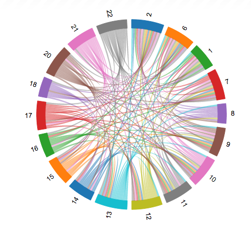

Whats your network map look like? mine runs 100% stable and looks like this.. devices are aligned in all sorts of orientations too, #8 is at the street and horizontal.

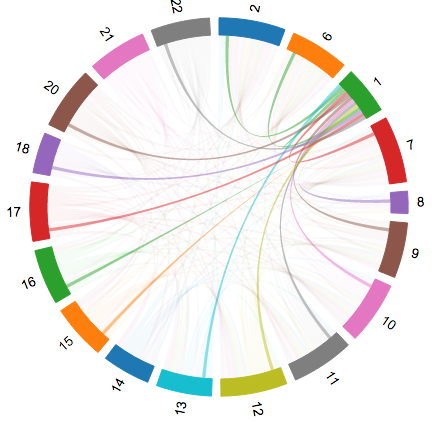

not having any lines is not good, Ive got lines to each of my devices except 21 & 14, they should but they have not been triggered in quite a while and likely been asleep when the heal occurred last.
sounds like you need more devices and/or a better location for your controller.. I started out by putting hardwired devices closer to my controller and worked my way out throughout the house until I had devices on each level with a direct link to the controller, then came back and filled it in and never ran into any sort of range issues.

it looks like you got a fine mesh network there, excluding your controller.. eek.
something is definitely not right here, have you tried another power source for your Z-Stick or the device your Z-Stick is plugged into?
Try moving your device around your house and leave it there for a while, see if it builds a better connection.. maby your controller is in some RF dead spot or being messed up by localized interference.. is there any equipment near your RPi/ZStick? Stereo Amps, High Voltage Appliance, any sort of transmitter, electric motor, or magnets? You dont have it locked up in a faraday cage do you :lol:
