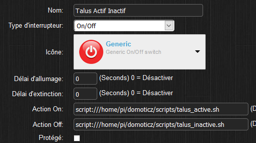

Hi everybody,
Finally I found a solution to do this.... Update the switch configuration in the domoticz.db database directly.
1. I started by installing sqlite3 on my raspberry pi:
2. I wrote two bash scripts, one to turn all events from my real switch to "Active", the other one to turn them to "Inactive": (in this example, "Talus" is the name of my real switch)
and
3. I created a Virtual switch and assigned these two scripts to "Action On" and "Action off":
4. When that virtual switch is turned ON, all planning events of the real switch are activated:
....and they are deactivated when that virtual swith is set to OFF:
Looks like my "problem" is solved !
Best regards to all, and sorry for the screenshots in French!
