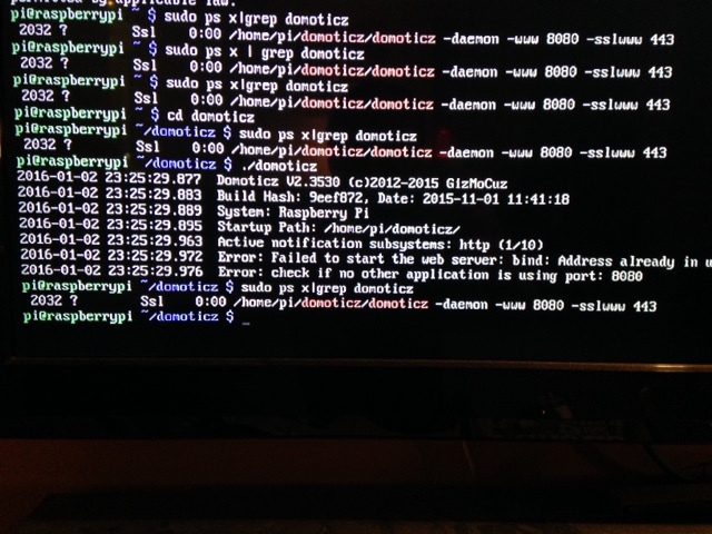

TheBod
- Posts: 52
- Joined: Friday 01 January 2016 20:46
Re: Idiots guide to Raspberry Pi Installation
Hi Jos
Thanks for your reply. I have tried
sudo ps x|grep domoticz
and get the response shown in the attached (2032 ? Ssl 0:00 /home/pi/domoticz/domoticz -daemon -www 8080 -sslwww 443)
Any ideas?
The Bod
Any ideas?
The Bod
- Screenshot of Pi2 response
- IMG_8286.JPG (138.15 KiB) Viewed 5560 times
- jvdz
- Posts: 2486
- Domoticz version: 4.107
So that means it is running already
Have you tried opening the Domoticz website from your PC's browser: http://rapsberry.ip.address:8080 ?
Jos
Jos

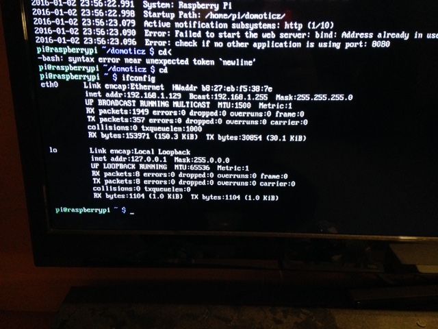

TheBod
- Posts: 52
Jos
This is what I get when i do ifconfig
Does this mean that the ip address is 192.168.1.255?
- IMG_8287.JPG (120.56 KiB) Viewed 5519 times
- jvdz
- Posts: 2486
Nah, 192,168.1.129
