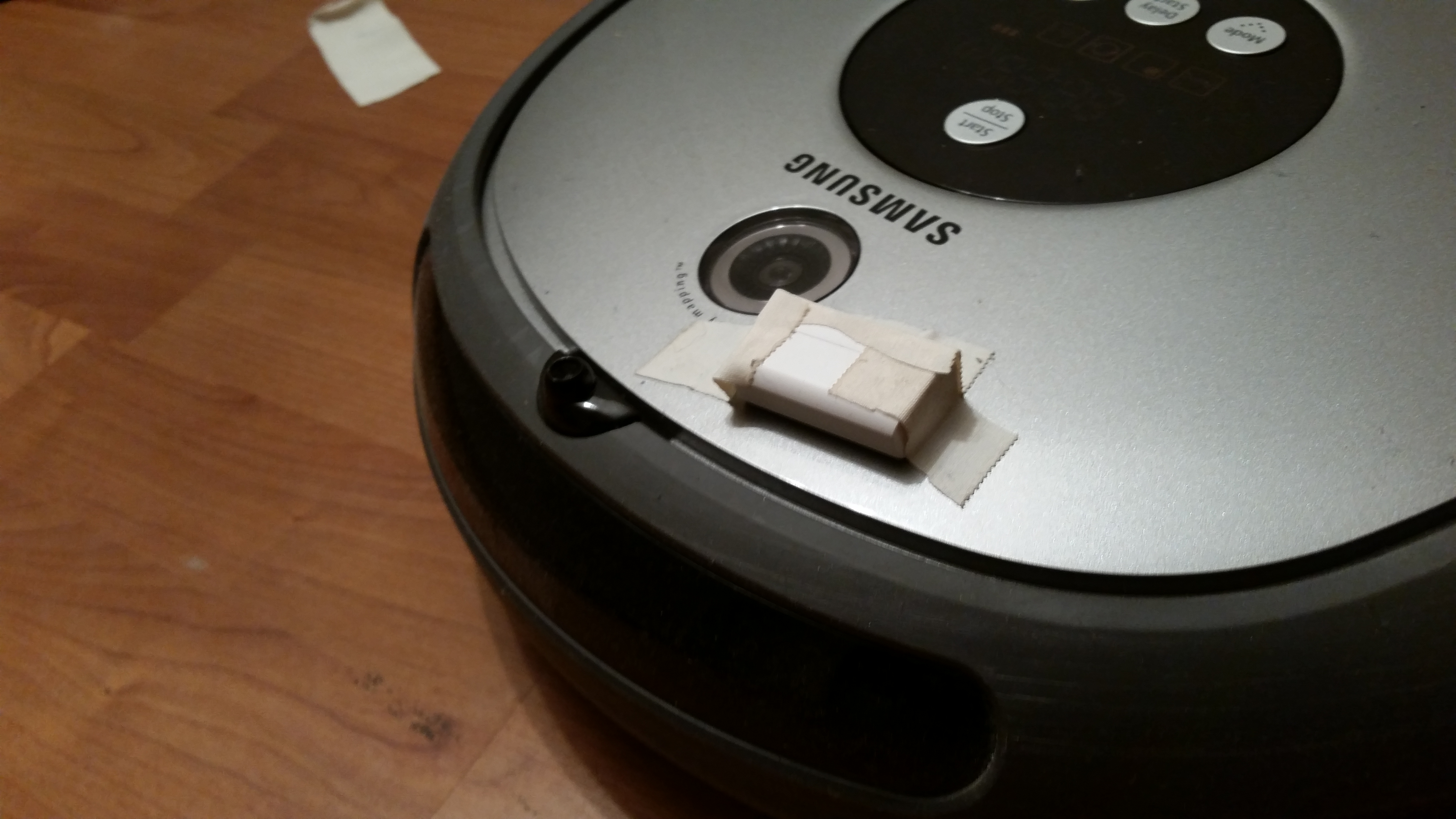

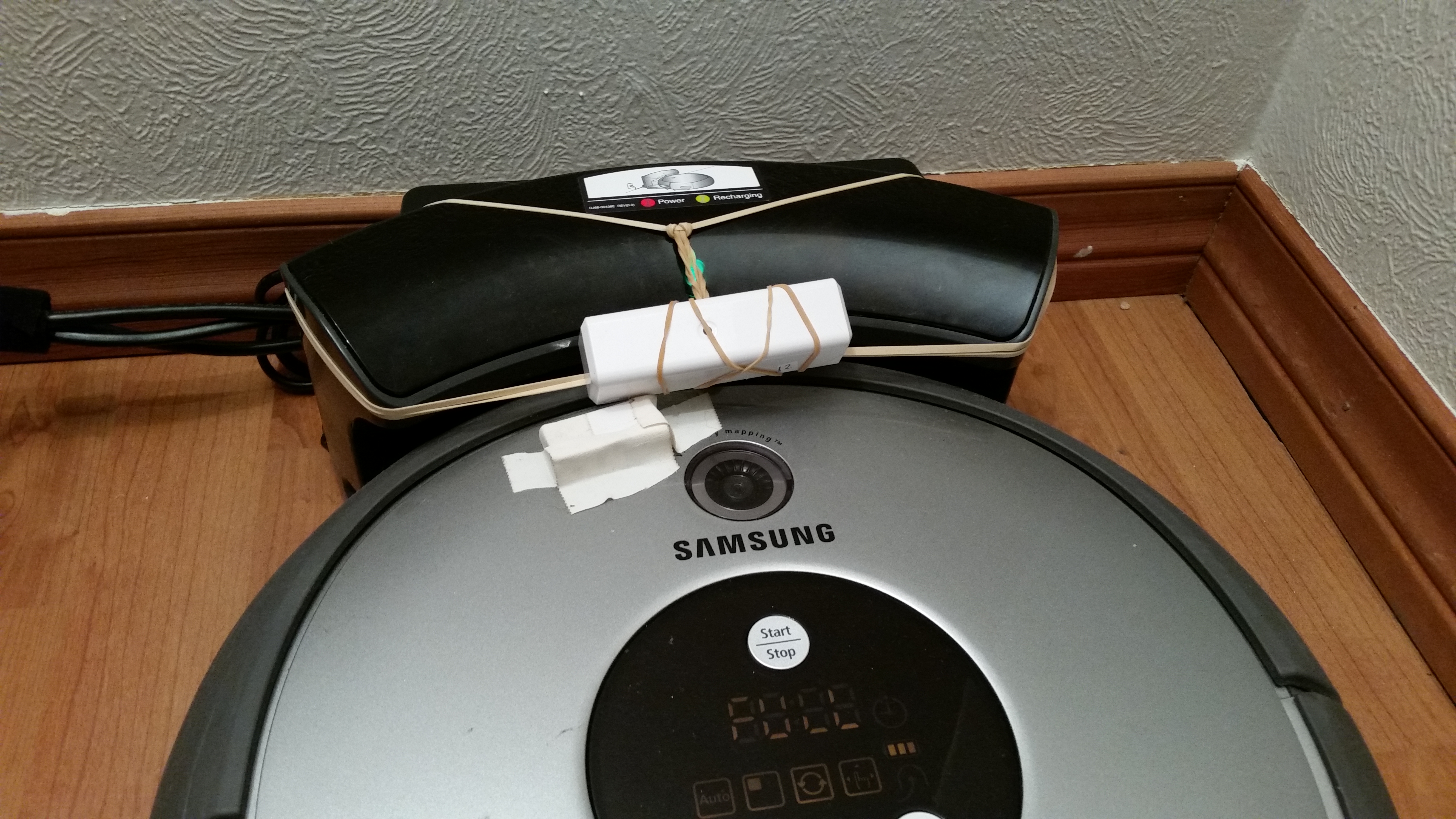

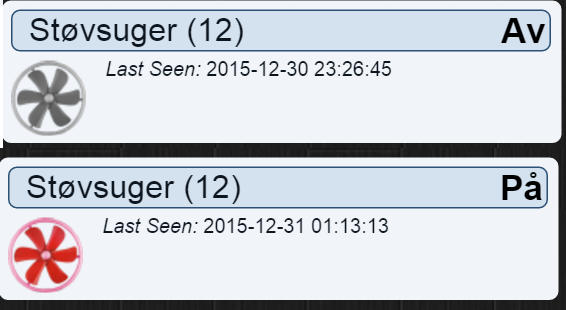

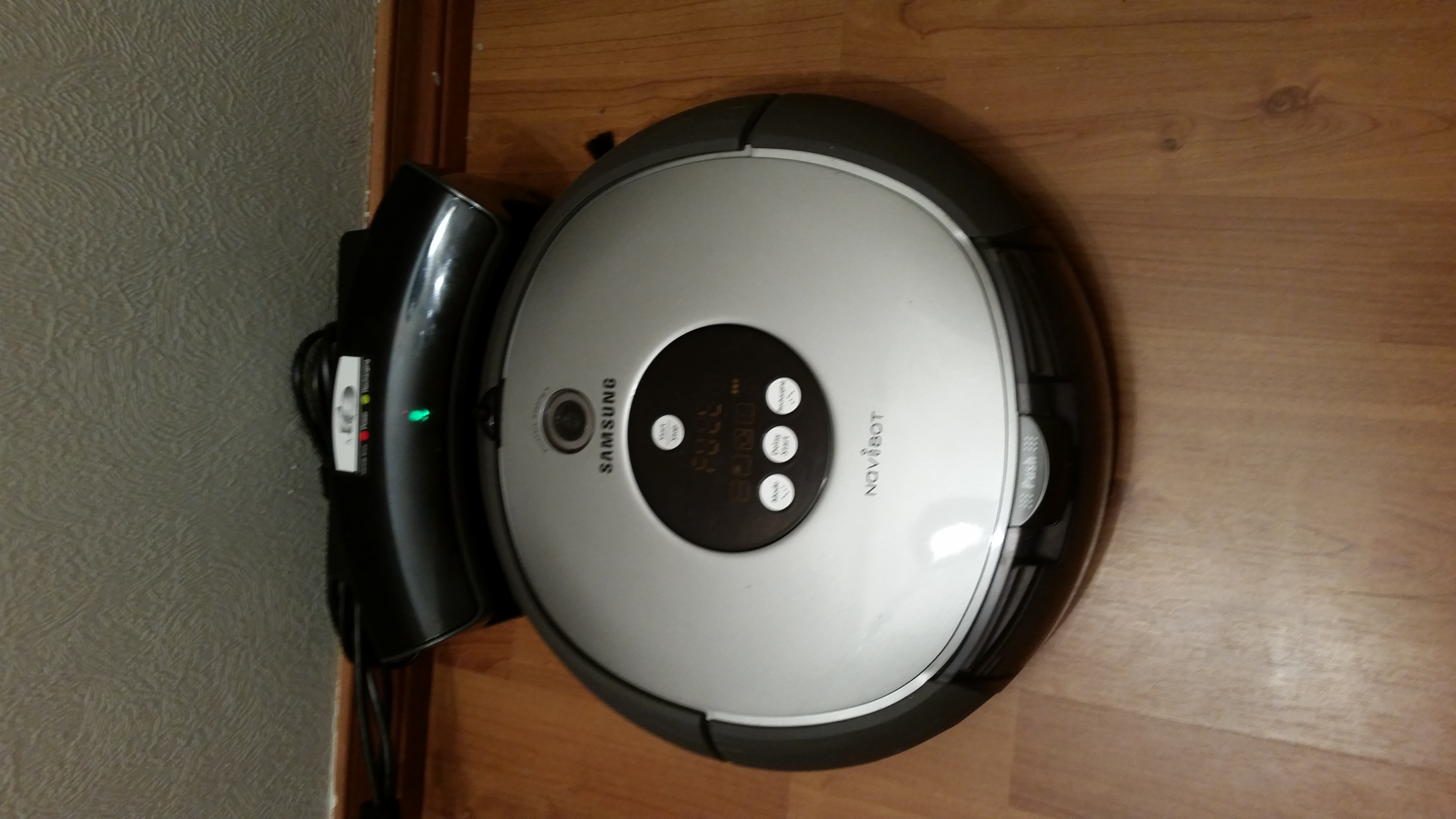

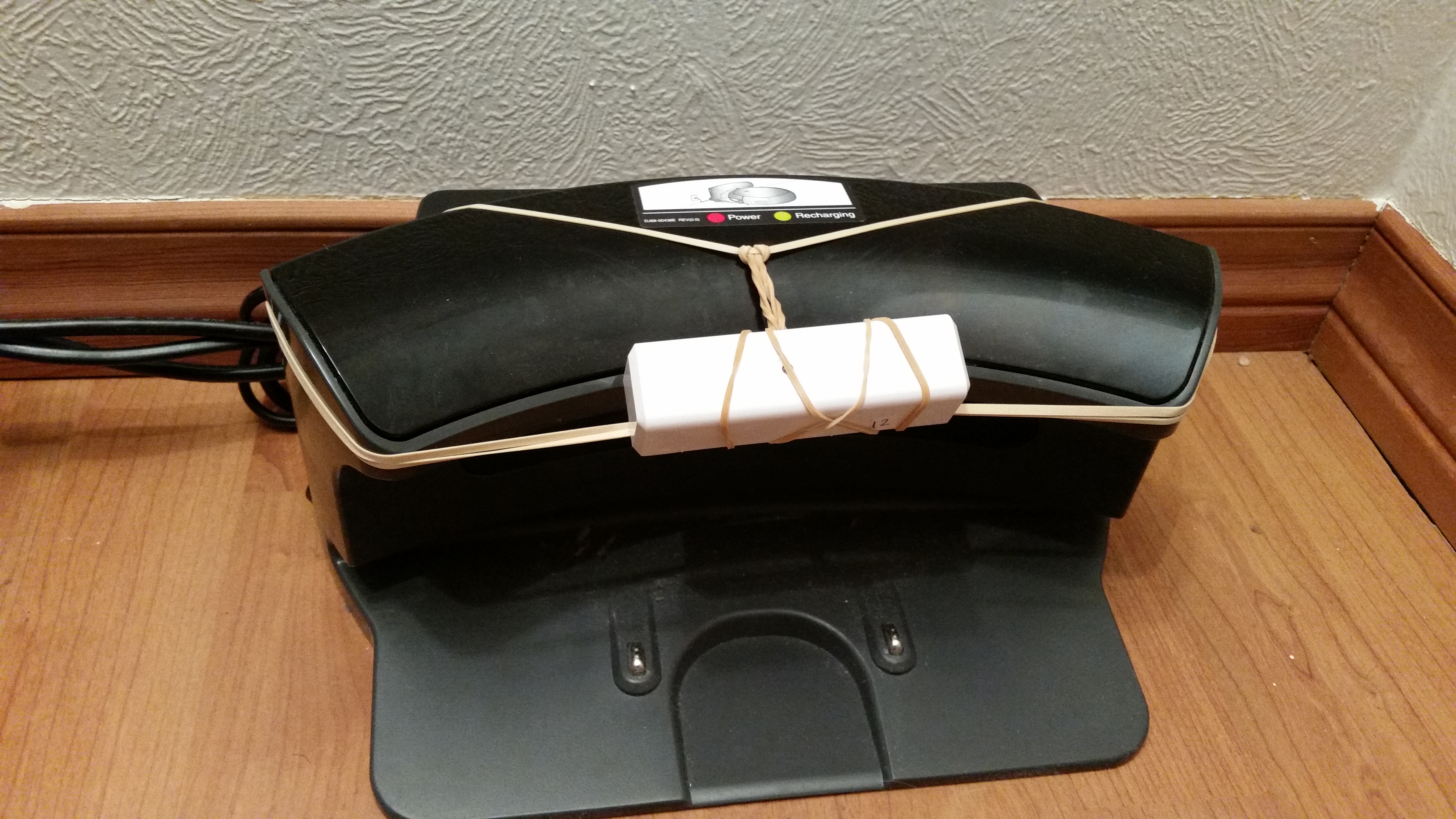

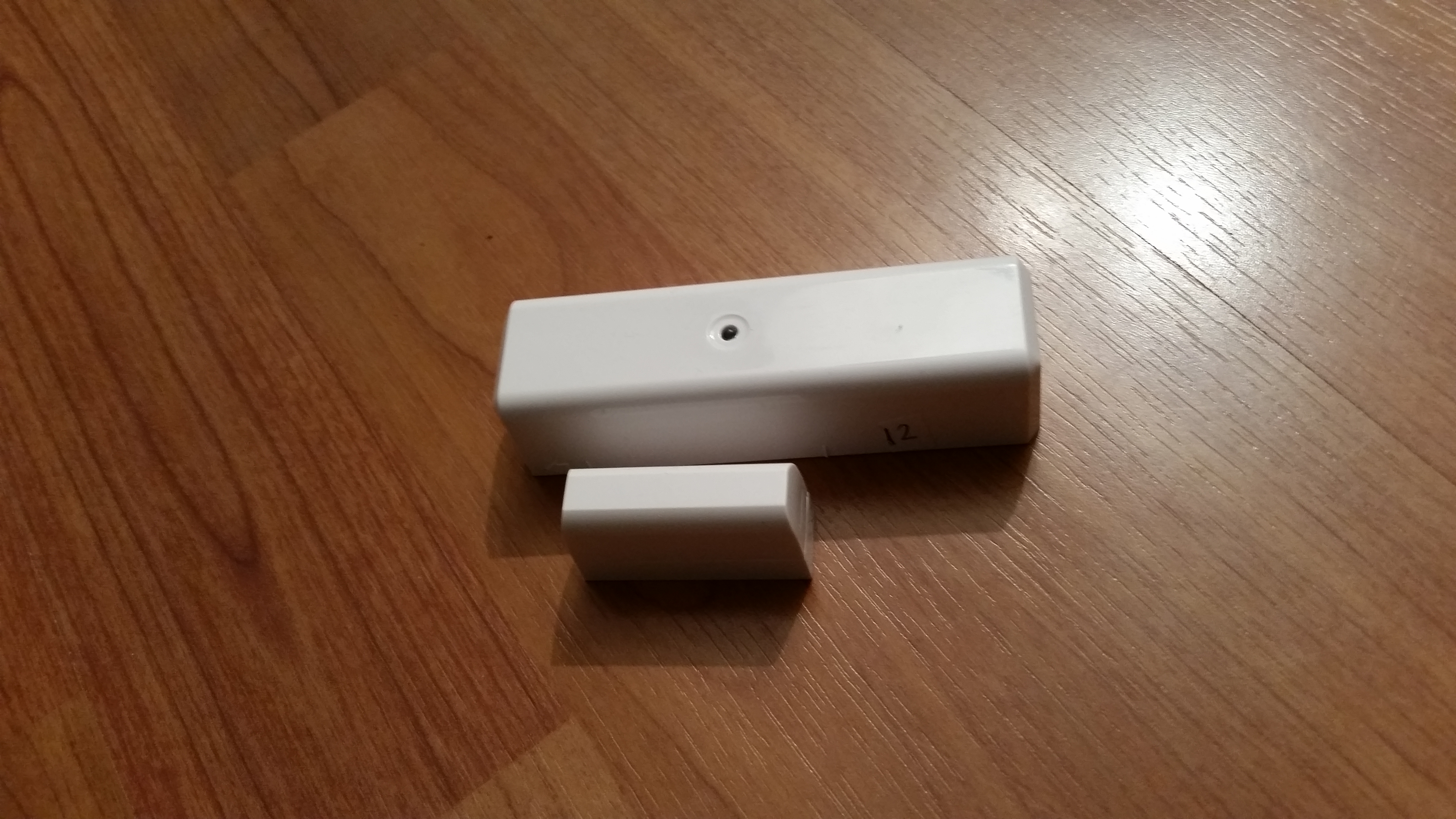

Todays project
Using a a Z-Wave contact Sensor (door sensor) to display the robot vacuum cleaner's status Domoticz
ON= Cleaning the floor
Off= Charging (docking)
Sensor: Vision ZD2102: http://www.clasohlson.com/no/Z-Wave,-Vi ... kt/36-5749
Images:
