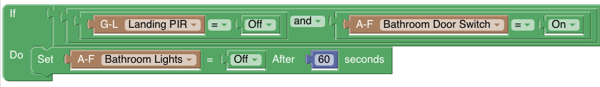

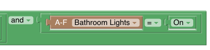

I understand I need to put in checks into the event to see if devices are on or not before continuing so that events aren't triggered every minute. With one event though, it doesn't trigger at all if I put this check in (Is light on?) unless I trigger the light on manually within Domiticz. If the light has been switched on by another event, it does't trigger.

This is how the event is now, obviously it turns the lights off every minute from 21:00. If I put in 'AND bathroom light = on' to the end of it, it doesn't trigger, even when all conditions are met.
If I click on the device to turn the light off and then on, the event then triggers.

Question: does the other event that switches the light on, also update the status of ['Bathroom Lights'] in Domoticz?
The blockly in your first screenprint does not run every minute. It only runs whenever the ['Landing PIR'] or ['Bathroom Door Switch'] changes its state.
It will run every minute though if you add the statement that is shown in your second screenprint, because the time will change every minute.

The images are from the same event, I couldn't view it all in one go to capture the images, so it does have the TIME part at the end. So every minute it turns off the Bathroom Lights (which is seen in the log). If I add 'AND Bathroom Lights = ON' to the end of this event to stop this triggering every minute, it doesn't trigger at all, even though the lights are on and showing on in Domoticz (unless I switch the light off then on in Domoticz manually) .
Yes the other event does change the status of Bathroom Lights within Domoticz.

mrf68 wrote:So if I understand it correctly: the script does work when you activate the switch manually in Domoticz, but when the other event activates the switch the script does not work? In that case the cause of the problem could be in that event. Is it a switch that is a slave for the main device?
Correct, that is the case when the event ends in
Screen Shot 2016-01-01 at 20.35.50.png (15.03 KiB) Viewed 2885 times
If I leave the end bit off, it triggers fine (but triggers every minute, which isn't really an issue but I was trying to keep the script efficient)
To clarify I have 3 events to control the bathroom light:
LandingPIR - Turns on the light for 1 minute if motion detected, it is dusk, bathroom lights are off and between certain times
DoorShut - Keeps the light on if the door is shut, it is dusk and between certain times, so that it doesn't turn of when someone is in the bathroom longer than 1 minute
LightsOff - Switches the lights off after 1 minute if no motion detected, Door open and between certain times
If I add 'and Bathroom light = ON' to LightsOFF, it does't trigger, unless I switch the light manually
Also, just to test, I added 'and Bathroom light = ON' to DoorShut script, it does't trigger, again unless I switch the light manually.

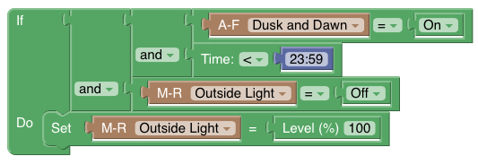

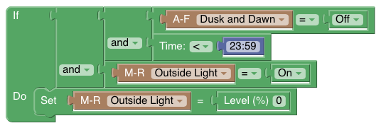

I've just set up two new events and the same thing happens:
Screen Shot 2016-01-20 at 18.15.42.png (33.38 KiB) Viewed 2740 times
The first event runs fine and switches on the light. When the dusk sensor goes off, the second event doesn't trigger, unless I switch the light off then on manually in Domoticz, or remove the 'and light is on' check from the event as before.
It seems that if an event uses the status of a device that is changed by another event, it doesn't seem to trigger correctly.

Posted: Wednesday 20 January 2016 22:22
by bizziebis
You check if Outside Light = ON, when it actually has the status SET LEVEL 100.
Try to change your Blockly to:
.. AND 'Outside Light /= Off
DO ..
/= is the not equal to symbol.
Re: Event doesn't trigger automatically, only manually
Posted: Wednesday 20 January 2016 22:36
by bubbaphatass
Ta da! That seems to of worked. So although setting the light level turns it on and it shows as on in the GUI, the actual status used for triggering etc might not be 'ON' ?
I'll try changing my other scripts now...
Many thanks!
