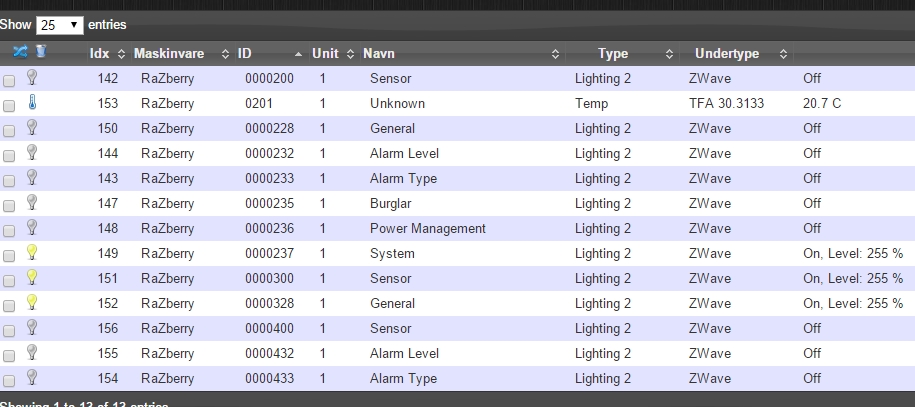

Re: Struggling with Fibaro FGMS001 and Z Wave Aeon USB contr
Hi, does your devices show up as other than Lighting 2 in devices? All of mine shows up as Lighting 2 exept of the Lux sensor.
Maybe this is not a problem, but i wanted the temperature to show up under Termperatur and Lux under sensors and so on, but I have not been able to get them other than under Switches.
