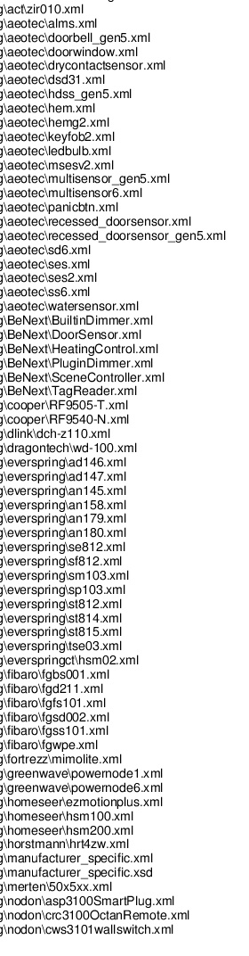

With Domoticz release 2.3799 there is a huge update of OpenZwave manufacturer specific Config files.
See: https://github.com/domoticz/domoticz/co ... 96064cf710
This is a result of the OpenZwave update:
Fixed #704 - AutoAssocicate should work regardless of Config file presence:
https://github.com/OpenZWave/open-zwave ... c44b5cecd7
A list of the affected devices (scroll down to see if your devices are on the list):
Affected files1.jpg (151.56 KiB) Viewed 1288 times
Affected files2.jpg (103.02 KiB) Viewed 1288 times
A sample of the affected code in the manufacturer specific Config files: removal of auto="true" ( - sign and + sign)

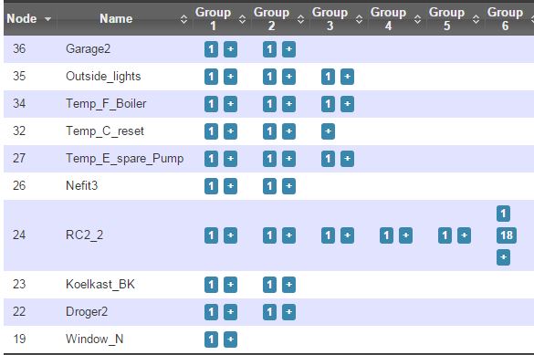

As I understand, it's about this table:
What exactly is the meaning of this change? Who can explain this?
What do we need to do to ?
Re-Include all affected nodes ?

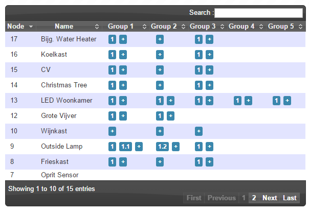

Yes, indeed there has been a change. I have had "1.1" entries for some time, but now I'm also seeing "1.2" entries.
Domoticz 41.png (22.87 KiB) Viewed 1269 times
I also wish I knew what these 1.1 and 1.2 entries mean...

I think the 1.1 and 1.2 has something to do with multi instance associations
What type of device is node 10 ?
Why is it not associated with your Controller 1 ?

Domosapiens wrote: What type of device is node 10 ?
Oops! I hadn't noticed that...
It's a Fibaro FGWPE Wall Plug. I don't know why it was showing no associations. Now it's showing the Controller (device 1) associated with it in Groups 1 and 3. I didn't add the associations myself, something must have made it happen...
All the FGWPE wall plugs are showing the controller associated in Groups 1 and 3. I think this is the default, but I've been reading elsewhere in the forum that apparently the controller should only be associated with Group 3 by default?

Read here at the end:
http://www.pepper1.net/zwavedb/device/476
The Controller (1) Should be at least on Group 1 for Fibaro FGWPE Wall Plug

A.f.a.i.k. you can ignore this change.
For Domoticz you only need the nodes to associate with the controller and nothing more.
For most devices this is group 1 but for some it is group 3.
