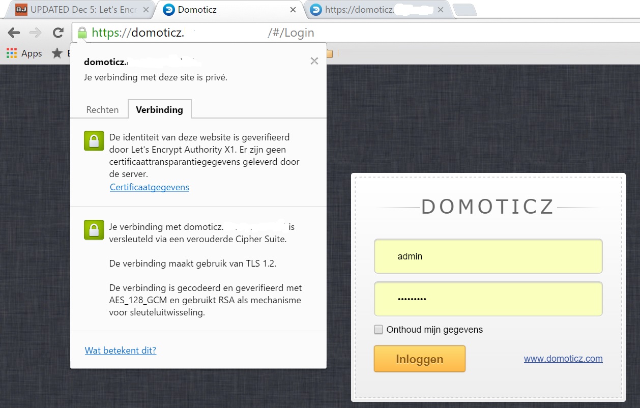

Got it working this weekend! This week i'll create the write-up/wiki page so everyone can use it.
Tested with ssllabs.com and got a B.
In the upcomming weeks I'll try to improve so we can score an A+ on our Domoticz servers.
