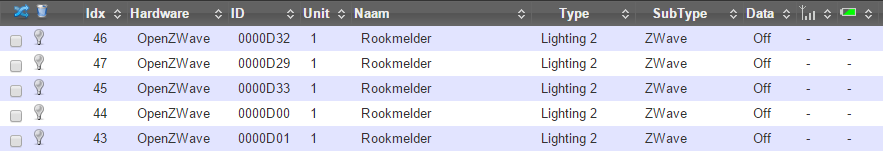

Just starting with Domoticz and Z-Wave, and having trouble identifying correct sensors of a POPP smoe detector. Hardware is detected as Popp Unknown.
I see 5 sensors all of them are Lighting 2 types...which one is the actual smoke detection alarm?
And which one is the manuel siren function? Is it the only one I can turn on...or is that the actual smoke alarm?

i think the one with 29 on the end is the actual smoke sensor
static const _tAlarmNameToIndexMapping AlarmToIndexMapping[] = {
{ "General", 0x28 },
{ "Smoke", 0x29 },
{ "Carbon Monoxide", 0x2A },
{ "Carbon Dioxide", 0x2B },
{ "Heat", 0x2C },
{ "Flood", 0x2D },
{ "Alarm Level", 0x32 },
{ "Alarm Type", 0x33 },
{ "Access Control", 0x34 },
{ "Burglar", 0x35 },
{ "Power Management", 0x36 },
{ "System", 0x37 },
{ "Emergency", 0x38 },
{ "Clock", 0x39 },
{ "Appliance", 0x3A },
{ "HomeHealth", 0x3B },
{ "", 0 }

is the "I think it's 29" now proven to be the smoke sensor? Could be severe to just rely on "I think"
