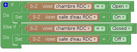

I answer myself. I managed to do it, but the controlling device must be outside of the group it controls, otherwise the events go crazy, it loops, with my ZWave devices. See the 1st example. "Volet séjour" must not be part of group "Volets pièces de vie".
I attach another example where there is a slave shutter ("Volet salle d'eau RDC"). It opens or closes at the same time as the master shutter ("Volet chambre RDC"), and it even follows master shutter's planning.
By the way, with Blocky, you must look at open/close events on shutters, but you must use On/Off when setting actions, that's not very intuitive.
