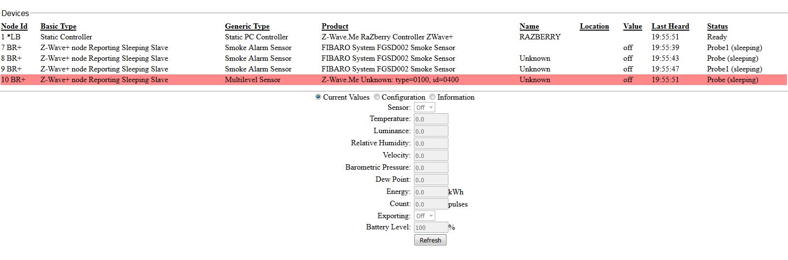

Still no data received.. However I am not experienced in Z-Wave devices, I migth do something wrong... Just been running some 433 devices for a month now and it works fine, mostly, so I realized I wanted a more reliable system for critical functions. Yesterday I started with some Fibaro Smoke sensors and they showed up with sensor data. I did not test if they trigger fedbeck on smoke or heat but will test that to be sure.
I have tested manualy "request configuration" but no responce from the Z-Weather (or smoke sensors), only time I get "last seen" updated is if I "repair" the nodes or Razberry radio.

i see there is no configuration file for the z-wave.me
my test node was showing as 'popp'
you could copy/paste the popp configuration in the manufacturer specific file and add it to Z-Wave.me
also make sure your controller (node 1) is in group 1 of the zweather, better to consult the manual to see to which group the zweather is reporting (most times group 1)
