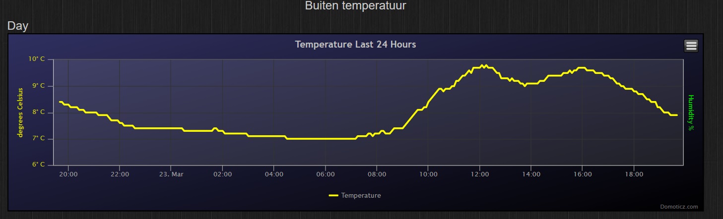

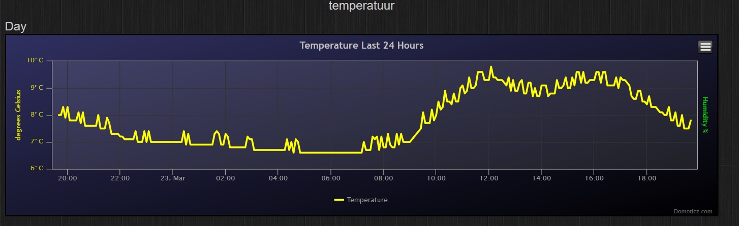

after that the zmnhad1 came online again but the temp sensors(i have 2 entries) were not working anymore.
i deleted them, did a reset and one came back, the other not.
after playing with it for a couple of hours i suddenly got temp sensor 2 back.
Now here's the thing.
before all this i noticed that if i gave the temp an offset the 2 temperatures were not always the same
somwetimes temp 1 was exactly the offset lower(eg 0.4 degrees lower)
after a couple of minutes they were the same
now if you look at the grapfic of temp1 you see all these spikes. These spikes are caused by the temp offset. it sometimes looses the ofset
temp2 however is very smooth and never looses the offset.
here is my thought.
at first when you include the zmnhad1 you only get 1 temp.
after changing the offset you get the second one(temp2) who represends the temp+offset.
really strange behavoir
i also inspected the xml files and some things have changed but not things who could have caused this.
