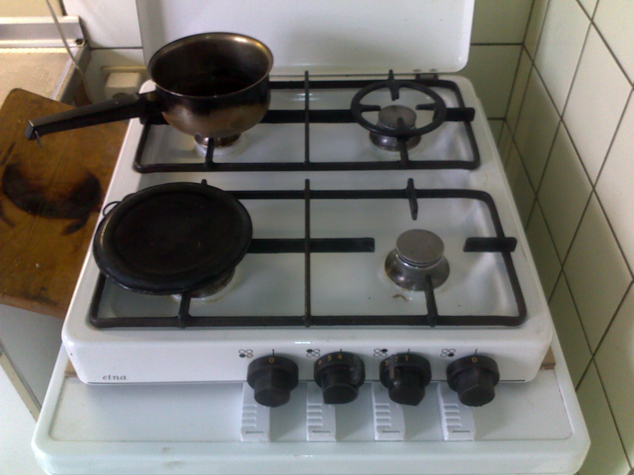

the gas-cooker
the gas-cooker

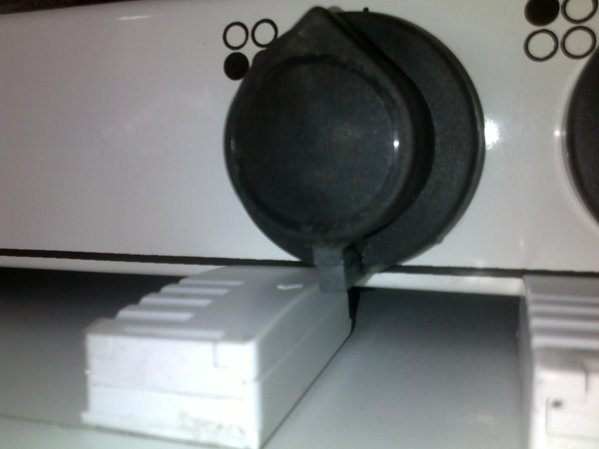

magnet and transceiver on the stove
