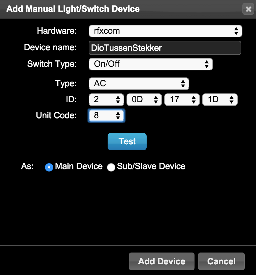

rgroothuis
- Posts: 347
- Joined: Friday 03 April 2015 17:09
Re: DIO PDR-2300
I've read that post but my Dio device doesn't have a test button.alfred_j_kwak wrote:Check post #10 in this thread and page 27 from Domoticz manual.
Anyway, the supplier told me the trick today and it is working now.
If you don't have a test button you need to insert the device into the outlet then the led will start blinking and at that moment you need to -push the test button in the window were you manually add a light switch. You need to choose the AC protocol and select just a random code as long as it is unique. See also screen shot.
On my side it is working now.

So just like in Domoticz manual in page 27.rgroothuis wrote:..push the test button in the window were you manually add a light switch.alfred_j_kwak wrote:Check post #10 in this thread and page 27 from Domoticz manual.
rgroothuis
- Posts: 347
Re: DIO PDR-2300
Fully agree, it is the test button in Domoticz and not in the device itself.
On the Fibaro wall-plugs there is a button that needs to be pressed when including them into the network. I was expecting the same with the Dio device. Sorry for the confusing, it is clarified now.
