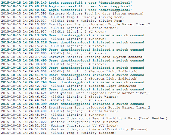

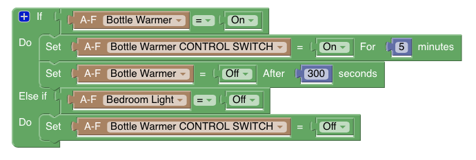

My RFXtrx433E arrived today, I have set it up within Domoticz and paired some devices with it. I have one lightswitch (plus one wireless 'slave' device paired) this works as expected with dimming functionality and the wireless 'slave' updates Domoticz as expected. I also have three LWRF wireless plug sockets, within the Domoticz web UI I can turn the devices on but the status does not update therefore when I press again to turn the device off the 'On' command is repeated and I cannot turn the devices off. I use the Domotix app and I can turn the device off from there by first sending the 'On' command via the switch in the app and then pressing again to turn the device off. It seems very strange that I can control from the app but not from the Web UI. I can control one of the plug sockets through an event and a dummy switch, it will turn on and off depending on the position of the dummy switch but as with the other two sockets, I cannot operate it using the switch paired with the socket ('Bottle Warmer CONTROL SWITCH')

Any suggestions, I don't know where to start troubleshooting!
