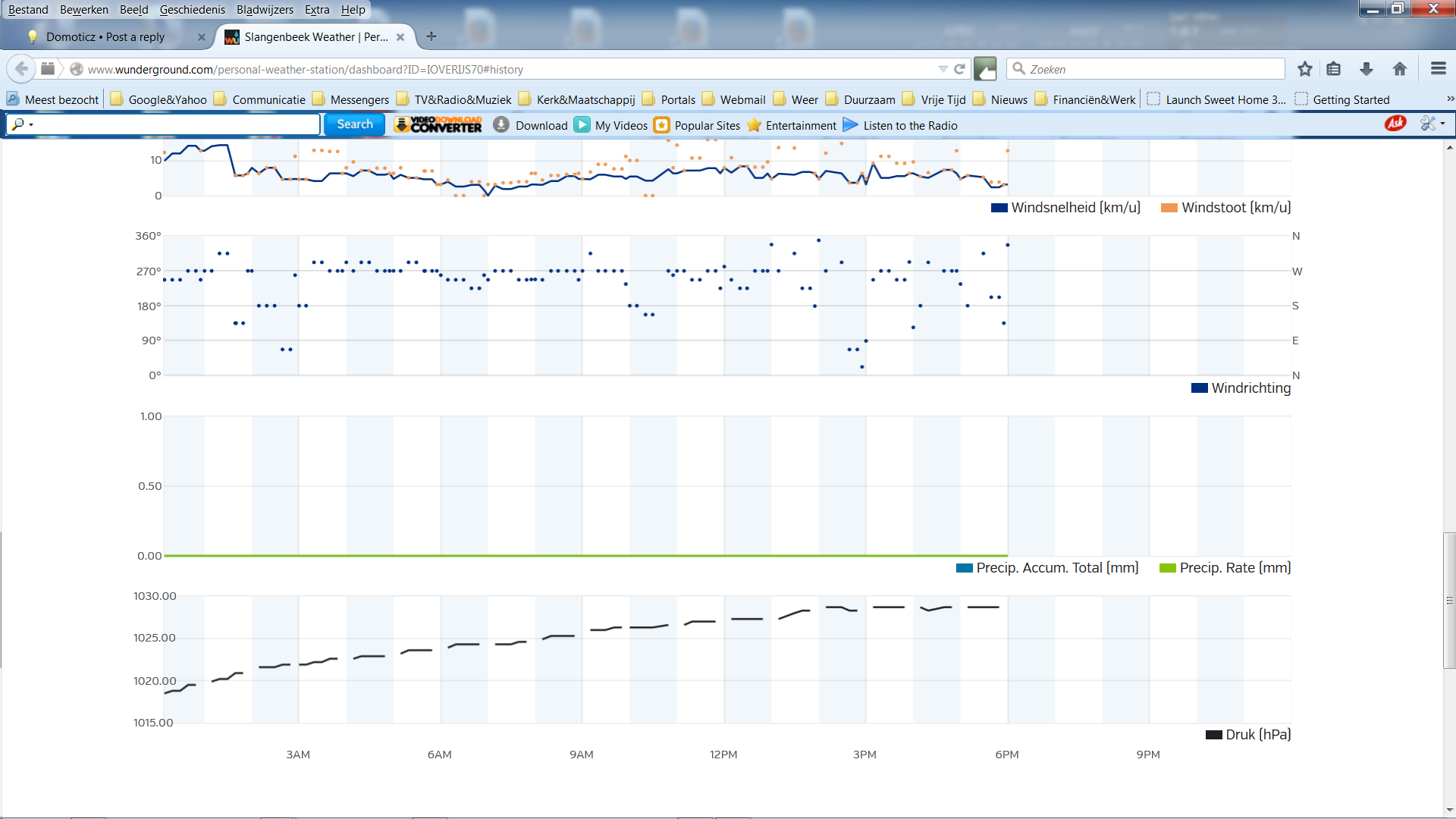

Presently running upload of meteo-data from Domoticz parallel to upload from WsWin.
Both Domoticz and WsWin take information from my meteo-set TFA_Nexus:
- WsWin gets the complete info-set via the USB-interface from the console
- Domoticz uses the wireless information from the sensors, which lacks pressure-info (because produced in the console).
WsWin-upload is at an interval of 10 minutes, Domoticz-upload is planned as backup at an interval of 55 minutes.
Wunderground merges both streams to one set of tables and graphs.
Not all ;-) 'sunshine' for this merging, because some side-effects in the Wunderground-display:
- in Daily Mode sometimes no data in the Summary-fields, because that function requires a consistent stream for some time
- for the Day-table and Day-graph all received data is applied, with the lack of pressure-info visible as -- indications in the table and as periodic 'holes' in the pressure-graph.
That latter effect for obvious reason: no data = no display .......
Goal (and benefit) of this setup:
the upload to Wunderground continues (with some limitations) even if my main server stops => improved continuity of information by redundancy
Schermafdruk 2015-04-13 18.01.05.png (206.52 KiB) Viewed 19055 times

This milestone achieved, but the result again causes some headscratching ( ;-) to keep me busy):
- a difference between the pressure info in the uploadstream from WsWin and in the uploadstream by this script can be expected due to difference in sensor, in type of measurement&processing, in timing etc. The difference seems a more or less constant bias. Because both uploadstreams are periodic with different fixed intervals, the difference in value shows as periodic zig-zags in the graph between the WsWin-value and the BMP180-value.
- but in the Wunderground graph/table at the points that the pressure from BMP180 is applied I also see significantly lower accumulated rain related to WsWin-info.
That makes no sense, because both uploads use initial data from the same Nexus-rainmeter.
I have the suspicion that the bookkeeping of Domoticz for accumulated rain is at least different from the 'real' meteo-software WsWin, possibly due to the different interval for read-out:
(in my opinion) therefore the upload from Domoticz is not a real substitute for info directly coming from a PWS, but at best a backup/gapfiller.
Interested to hear your opinion & experiences, and improvements.
