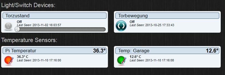

You are right,...but I've pre-installed two connectors to my GPIO pins. Both are set to "IN" using wiringPi.
Next is to install 2 sensors (contacts) showing me the postion "Full yopen", "Fully closed" or "Partly Open".
Currently I try to show the position using the dimmer symbol but couldn't get it working until today. I'm trying to use the slider of the dimmer symbol...
If I couldn't get it to work I will use 2 separate "contact" symbols.
Currently I have not installed the contacts due to bad weather conditions
Hardy
