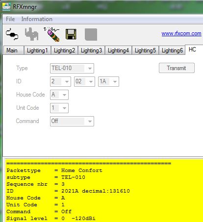

Hello
I just tested RFXmngr.
The selection I HC tab.
and selection of telecommandeTEL-010 (the remote control supplied with the ECR-100 module is the TEL-010 model)
I try a aperage but nothing happens.
I was therefore unable to operate the ECR-module 100 ave key RFXcom433E ....

Use an RFXtrx433E with firmware version 248.
Connect RFXmngr and enable only the HomeConfort protocol,
Transmit a command using the TEL-010 remote.
Check the codes received and transmit a command with RFXmngr using the same codes as received from the TEL-010.

It's ok
Home Confort command
Packettype = Home Confort
subtype = TEL-010
Sequence nbr = 6
ID = 1010C decimal:65804
House Code = A
Unit Code = 1
Command = On
Signal level = 0 -120dBi
Packettype = Receiver/Transmitter Message
subtype = Transmitter Response
Sequence nbr = 6
response = ACK, data correct transmitted
subtype = TEL-010
Sequence nbr = 7
House Code = A
Unit Code = 1
Command = Off
Sequence nbr = 7
Merci Thank's :p

Ok, HOME COMFORT modules are know seen under RFXmgr, but not by DOMOTICZ
