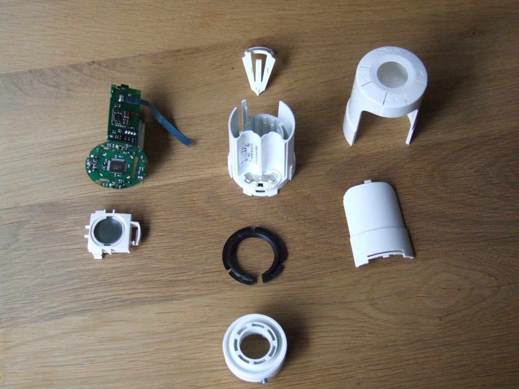

Today I also installed a bunch of these thermostats in my home.
Type 14G0013, the latest model, firmware version 1.00, supports sdk 4.55, but has no temperature measurement functionality.
This seems strange, since the device needs room temperature readings to work at all. I modified one of the thermostats to function inside a floor ventilation duct (convectorput in Dutch), opened one up, and connected a few meters of wire between the temperature sensor and the PCB, to measure temperature at eye level rather than inside the duct. The sensor is an NTC, type MF58D, not sure about the resistance range, haven't tested it. (This would void my warranty, but didn't have that anyway, bought the lot on marktplaats.nl
). The controller is an ATXMega32D4, with a whole lot of test contacts at the back of the PCB, shouldn't be too hard to tap into it to get actual temperature readings.
Is for later, though (I have one spare left, but lots of other stuff to finish first).

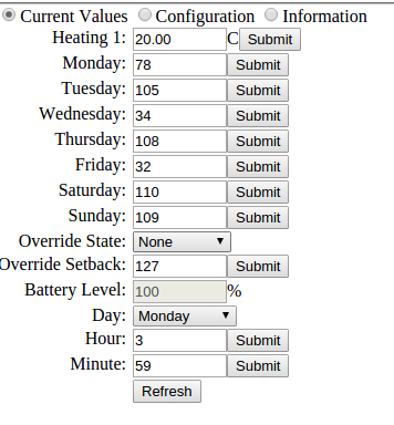

Re: Danfoss LC13 temperature
another 2 quetions hehe:
1- What is the best way to repair a E5 error?
2- This default values are correct? could be that the item was bad included? Any clould explain me that values?
- instantánea2.png (31.54 KiB) Viewed 10260 times
- Egregius
- Posts: 2592
- Domoticz version: v2024.7
- Location: Beitem, BE
E5 Means that there's no controller available. Is it to far from your Zwave controller? Do you have other powered devices around? How many devices are there in your network?
For the settings: I have all days at 0. Don't remember if I set it that way or that it just was like that. Don't think they mather much. They are mainly for programming the valve in a standalone situation. With Domoticz, you let Domoticz handle the programmation of time and temperatures.

Sorry to response on a very old message, but i am very curious about your experience with the Danfoss LG-13.marcelr wrote:Today I also installed a bunch of these thermostats in my home.
This seems strange, since the device needs room temperature readings to work at all. I modified one of the thermostats to function inside a floor ventilation duct (convectorput in Dutch), opened one up, and connected a few meters of wire between the temperature sensor and the PCB, to measure temperature at eye level rather than inside the duct. The sensor is an NTC, type MF58D, not sure about the resistance range, haven't tested it. (This would void my warranty, but didn't have that anyway, bought the lot on marktplaats.nl). The controller is an ATXMega32D4, with a whole lot of test contacts at the back of the PCB, shouldn't be too hard to tap into it to get actual temperature readings.
grtz,
marcelr
And with type of Antenna do you use for the connection with the LG-13
That's not a lot. I have hem connected to the radiators, set to a temperature setpoint, and that's it. They do their job. Haven't had the inclination to start tinkering with them yet.but i am very curious about your experience with the Danfoss LG-13.
Not sure what you mean with antenna. The z-wave antenna is inside the housing of the LC-13. It's the floppy strip of metal connected to the rectangular pcb, top left in the picture. If you mean the temperature sensor, that's a small NTC resistor, at app. 4 'o clock on the round pcb, centre left. I soldered it off the pcb, and put an extension wire in between.
grtz,
marcelr
- Danfoss lc-13, disassembled
- lc13.jpg (176.84 KiB) Viewed 8902 times
