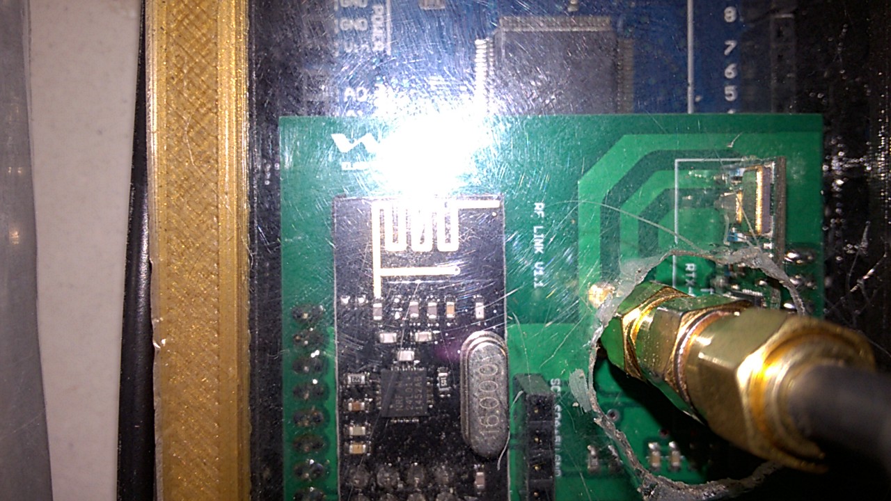

I have a 433Mhz RFLink per-soldered and a NRF24L01 on top of it.
I was under the impression the NRF24L01 was also a 2.4GHz tranceiver?

Posted: Friday 07 October 2016 11:07
by Stuntteam
Yes, the NRF24 is also 2.4 Ghz but can not handle the modulation required for the additional devices..

Posted: Tuesday 11 October 2016 0:13
by Stuntteam
RFlink is modular.. this means you can hook various transceivers to the mega and use their different abilities.
Milight communication is done using a NRF24L01.
Ikea Ansluta communication is done with a CC2500 transceiver. The reason that it does not work with the NRF as well is because a different form of modulation is used, modulations is the way 2 sides talk to eachother..
