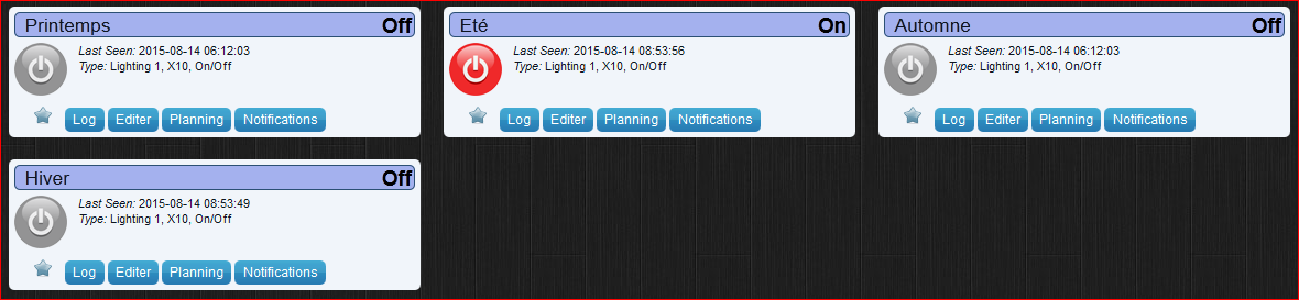

That's what I did:
Solution 1: Use dummy switches one for each season
with the following lua script that set each switch to "ON" or "OFF" depending on season change date
Solution 2: Use user variable
with the following lua script that change the value of the variable at season change date
Maybe it can help someone.
JC
That's what I did:

So what are your exact switchnames to use for the 4 seasons?
Jos
Jos
Derik
- Posts: 1605
- Domoticz version: BETA
Re: LUA: Summer / Winter from timeofday or other...
All dummys:
Voorjaar : IDX:4194
Zomer : IDX: 4195
Herfst : IDX: 4196
Winter: IDX: 4197
Voorjaar : IDX:4194
Zomer : IDX: 4195
Herfst : IDX: 4196
Winter: IDX: 4197

Derik
- Posts: 1605
The option from Jos, is without any hard to get stuff...... I got him working in a few minutes....deennoo wrote:Hello.
