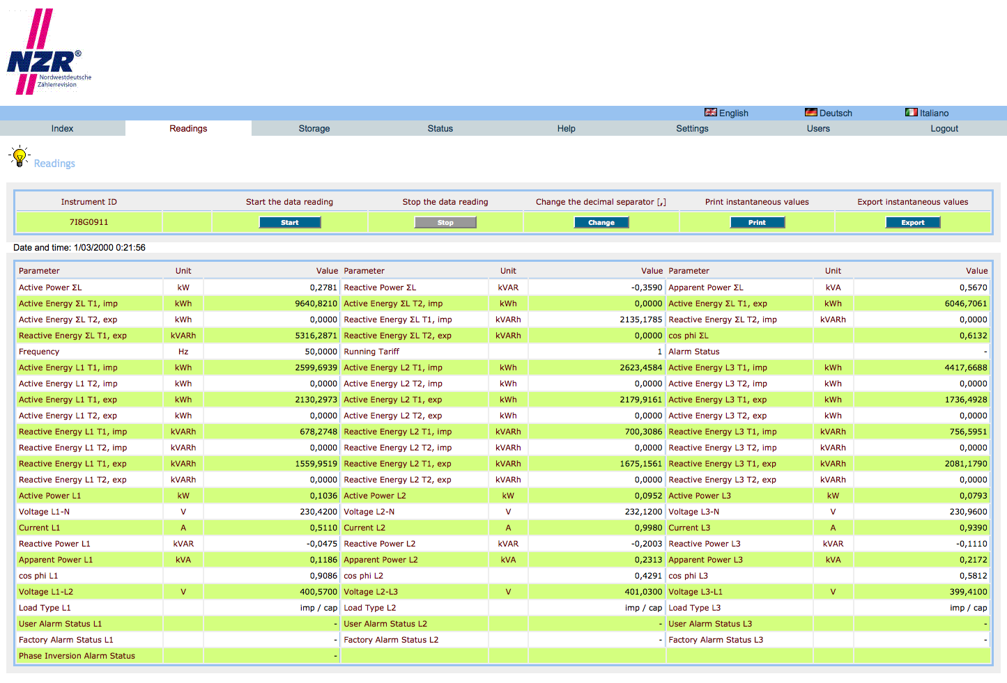

i have a WBZ from NZR (http://www.nzr.de/en/products/electrici ... r-wbz.html) with LAN Module
See the attached screenshot for the output of this device.
Greetings, Oliver
