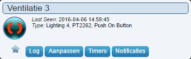

I bought
4 channel RC Switch.jpg (16.76 KiB) Viewed 10921 times
The remote works nice with RFXCom and the Lighting4 protocol. The receiver works also, but Domoticz has no set/reset switch so i need two make two switches to turn on/off 1 channel.
Also you can set 3 modes on the board and install a push button, push button = switch is on, push button again = switch is off.
ventilation switch.jpg (11.1 KiB) Viewed 10920 times
