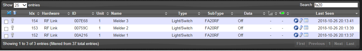

Recently I noticed my parents did not have any smoke detectors.
So I bought the fa21rf for 7 euro's each including batteries from a dutch vendor.
According to Stuntteam documentation they have to work with a RFLINK, and I do not want to have them paired. (pairing result -> all same ID)
To have individual devices in domoticz do the following:
- Press Allow new hardware for 5 minutes button (Setup -> Settings -> Systems tab)
- Put in the batteries of detector one.
- Press Test button for some seconds on the Smoke Detector to learn the device in Domoticz
- Find the newly created device (Setup -> Devices -> Not Used)
- Add the device to domoticz. It will appear as a switch.
- Now Press Learn button on the smoke detector untill red light turns on.
- Switch the Domoticz smoke detector ON several times until smoke detector starts beeping.
The device is now paired.
Repeat for all other units.
