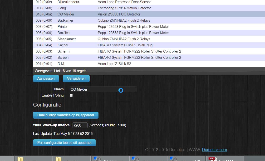

I have a Co sensor...
Vision ZS6301 CO Detector, for the safety of my family, because i use a pellet stove as heating in my house.
I try different batteries...
Only the battery will work no longer than 1 or 2 weeks..
Polling in the sensor is off.
Wake-up 7200..... is that a problem, perhaps?
In my Aeon Usb polling on 60sec
Is there a option in ZWave to save the battery?
Or do i need to rebuilt the sensor with a power adapter?
Other options?
Co sensor eats battery

I have set the wakeup interval to 86400 seconds. It save some battery, but I think the sensor is battery hungry.
Also I have turned off polling like you did.

Hi Derik,Derik wrote:I have a Co sensor...
Other options?
Quite odd I am even unable to include this Vision ZS6301 into the network? I press the program switch for more than sec, but it doesn't get included into the domoticz? Just wanted to check if there was anything else that you did to include this into the network?
